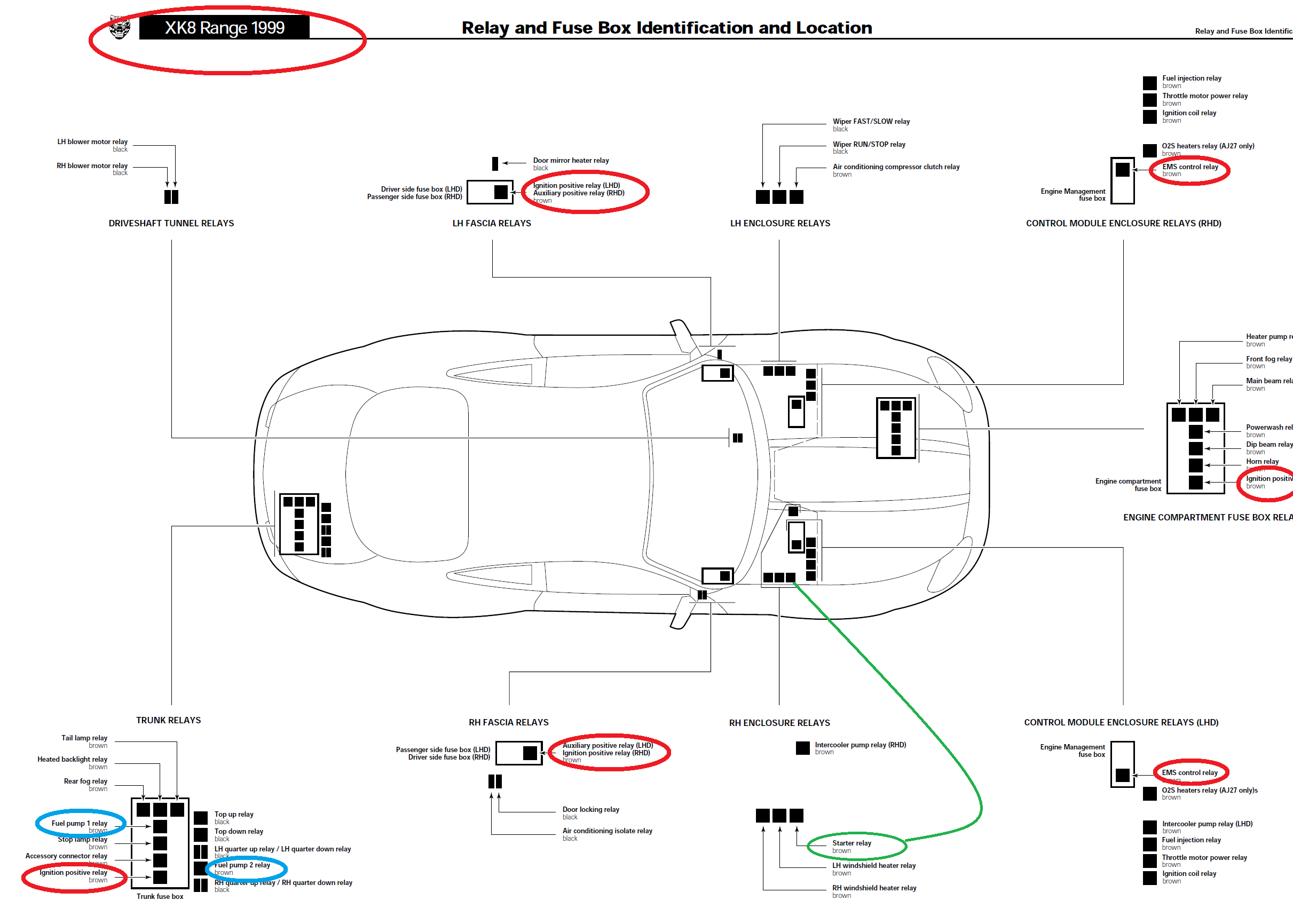

On the 2003 supercharged model there are 2 ( ? ) fuel pumps and the second one is commanded on at 4000 . Check the fuse and swap relay first . If it's only 1 swap the relay as it may be pitted causing lack of current . Fuel filter ?
See page 51 below
http://www.jagrepair.com/images/Auto.../jagxk2003.pdf
Hope this stops your spot of stumble under the bonnet .
Attached Thumbnails Stumble/Misfire on WOT between 4-5000 rpm-xk8-king-relays-untitled.png
