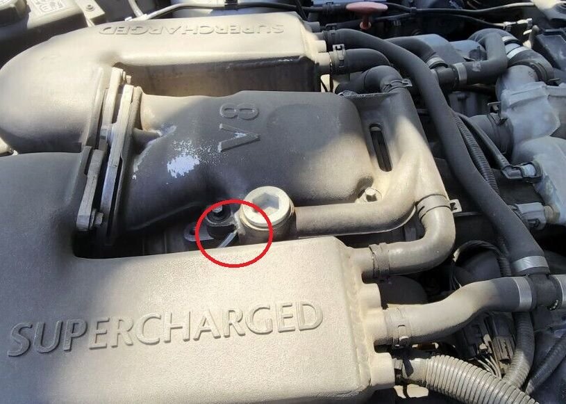

The Eaton supercharger on Jaguar XKR is actually not a compressor! It is more like an air pump that pumps more air into the engine. When more air are being pumped than the actual displacement of the cylinders, it creates pressure (boost).
At closed or part throttle you will get vacuum in the intake and this vacuum is used to hold the bypass valve in the supercharger open, meaning that the air will bypass the supercharger and go directly from the throttle body to the intake.
When you opens the throttle the vacuum will disappear and the bypass valve closes, forcing the air to enter the supercharger.
Up till then the supercharged engine will operate and work just like an naturally aspirated engine.
You will not measure any difference in vacuum.
The only place you can measure actual boost, is in the vacuum hose that goes from the supercharger to the fuel pressure regulator. You will se it on the right side of the supercharger outlet, just behind the big air bleeder/filler plug.
