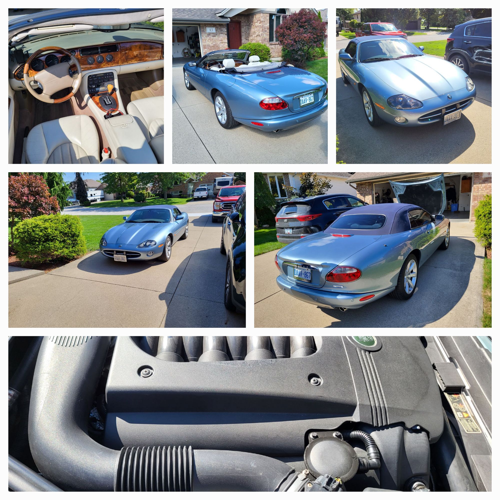

I'm kinda on the side of the ones who say buy it, because of the worst case scenario being an engine rebuild. I made the mistake of buying a 97 coupe that just needed a little body and paint work. It was really cheap, so I thought it would still be a good deal with the usual stuff needed. After $3K to get it up to safety standards, not bad considering. It just needed the rocker panels redone and a paint refresh. I started taking her around to body shops. I was quoted between $8k and $12k for rockers and respray, nothing special.
"Pandora" was summarily sold off. I did manage to recoup my investment...almost.
Since then I found a gorgeous 03 convertible with a perfect rust free, original paint body, perfect top, and pretty much all the usual work done, that had spent most of its life in Arizona. I spent too much money for it, but I figured that if I had bought any of the lesser ones I had seen for the usual going prices, I would have spent that much and more by the time I was done anyway. She's not perfect, the rear outside bolts on the valve covers seep just enough oil on to the exhaust to stink up the cabin. The mirror switch is balky, and the drivers side seat belt receptacle cover is broken. But she's a pleasure to drive and you could eat off the engine. Gonna keep "Misty"!
