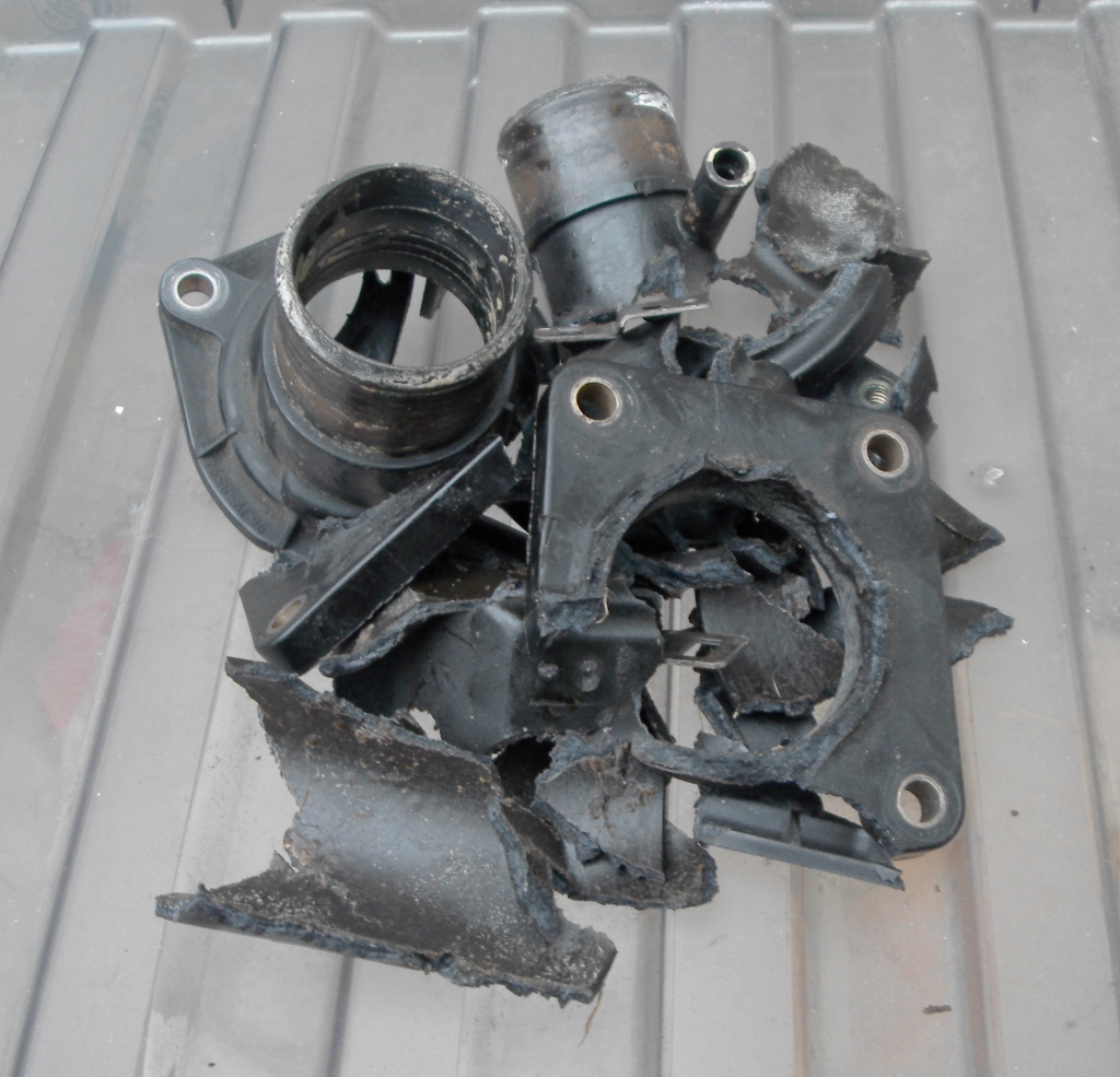

I can recommend the subtle & delicate approach to this problem :

How do you keep pieces of the tower from getting in the motor. I sure don't want pieces in my cooling system.

Stuff a rag in there, then vacuum the pieces out.

As RJ237 says .......... the material is brittle, but doesn't shatter - rather tears apart, so with a bit of care, there no danger of little bits getting into the cooling system.
For me this is the absolut easiest way......................
A simple solution with no risk.
