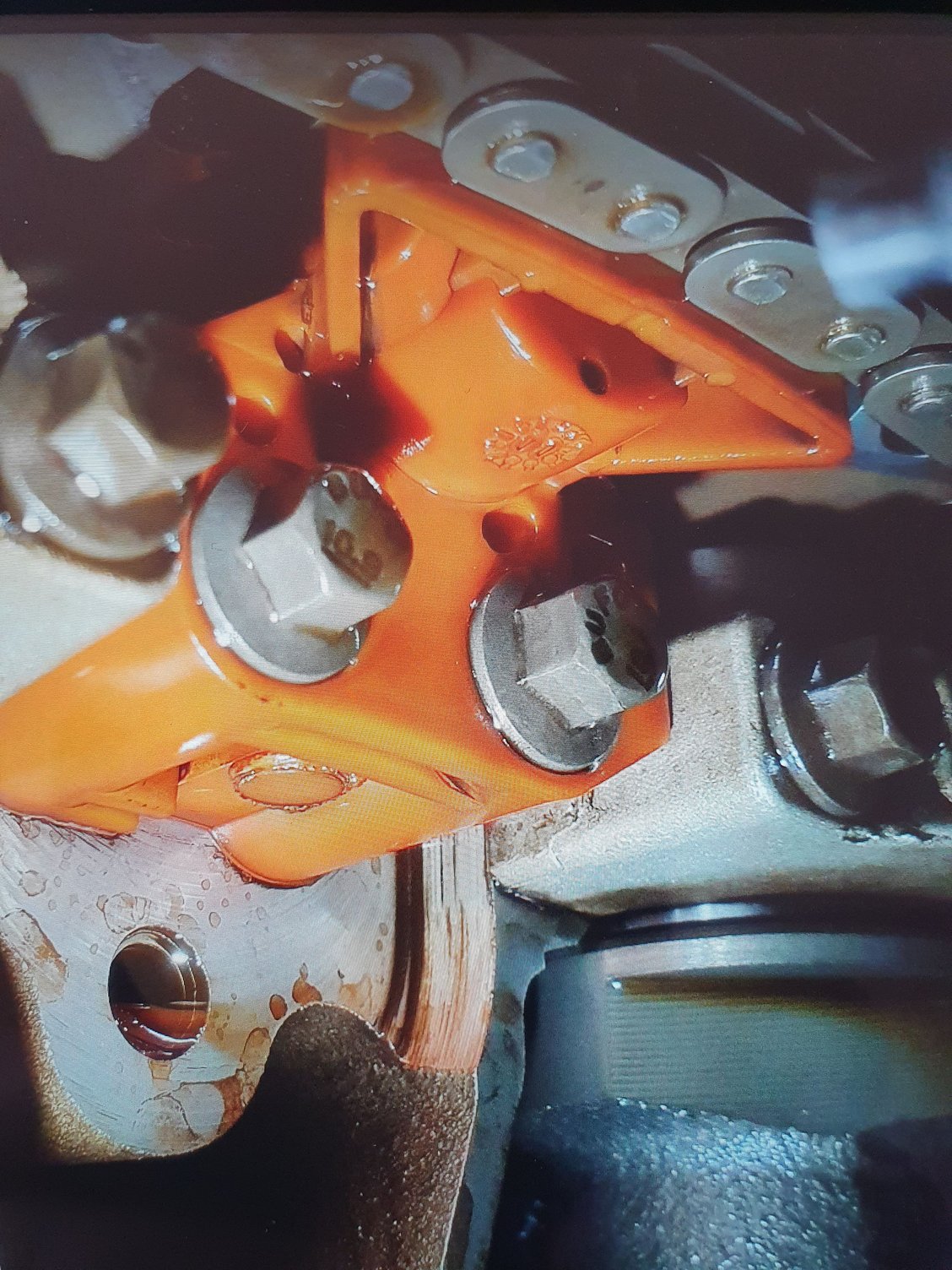

Managed to get around to removing the cam cover on my 2001 xkr to have a look at the tensioners. Bought the car last year and the p.o. couldn't give me any information on them one way or another. Other than that the car seemed ok. I have only done an inspection out of curiosity, nothing is amiss and I've not had any funny noises. As you can see from the photos they dont appear to have any problems. So which way forward? I'm tempted to leave them for now and just have the secondarys done in the future. Car has done 64k and all seems good. Full history upto 50k at dealers. After that its sketchy. Your thoughts please.

I can hear the chorus of screams building already....

Change the secondaries, at least. Often, the only warning sound is the valves hitting the pistons when the chain skips a couple of teeth.

Change them, you know it makes sense.

Like another poster mentioned. You have the failure prone plastic tensioners. Why would you want to leave them in knowing that one day they will bite you in the backside?
+1
Take a look at the other end of the tensioner where the piston is.
Please don't just put the cover back:- you're almost half way there already.

I should have explained a bit further. I have been quoted £300 to have the secondary’s done and £1080 to have the whole lot done. I was thinking leave them for now an£ spend my money on other maintenance like the brakes . Then certainly within the next 6 months either have the secondary’s done or depending on input the whole lot. I’ve no intention of not doing nothing just need to prioritise. A grand is a lot at the moment having been off work for 3 months and those tensioners have been ok for 20 years, another 6 months and low mileage? Just asking for some advice....

[QUOTE=michaelh;2237030]+1
Not sure what you mean?

The body cracks starting at the 'U' cutout and the piston can leave the building and get trapped between the chain and a sprocket:
I do understand your logic: best to have all done at the same time so you're not doing part of the same job twice.
Problem with the plastic bodied is that they could be good for another 10000 miles +. Or they could fail the next time you turn the key. There is no way to be sure.
I would definitely prioritise this job over a brake refurb.

Change them NOW. You already have 75% of the job done already. Replace with the metal body tensioners. If money is an issue, you can easily DIY this yourself using the zip tie method. Driving with the plastic tensioners is like playing Russian roulette with a nearly fully loaded revolver. They will fail and it could happen at any moment.
The primary guides are a different affair. You absolutely do need the special tools for these. However, those do give a bit of warning when they are starting to fail. Replace these ASAP but they can wait more than the secondary tensioners.
The brakes, while important, are in this case not as urgent. Postpone the brake unless you are at minimum thickness and max pad wear.
The tensioners don’t fail based on mileage, but instead because of age. There have been reports of low mileage XK8s with bricked engine due to the tensioners.

I've just had a look at the other side now I've got the cover fully off. Theres a crack down it. The tensioner is complete and the others further in the engine look good as far as I can see. Maybe just secondarys for now.

No question about it now
Hope you get it to the shop OK, scary.
