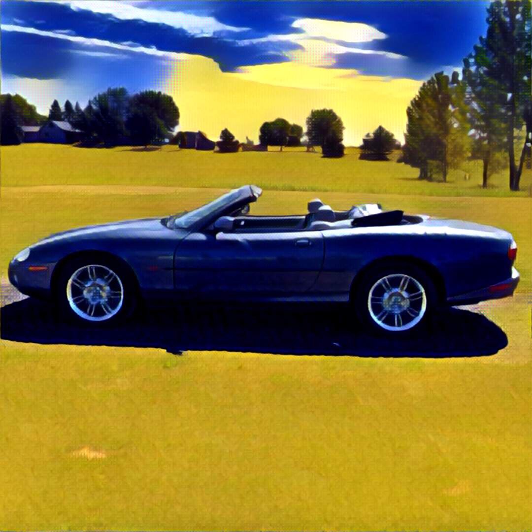

I think the wheels on that gorgeous black coupe are Jaguar "Impeller." I like them.
Attached Thumbnails TIRE QUESTION: staggered front &amp; back VS the same size?-img_0130-1-.jpg

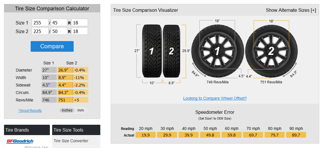

Let me rephrase: Have you ever noticed that any automobile manufacturer still in business today doesn't put larger front tires on their front wheel drive cars than those on the rear? lol...
The 2005-2008 Pontiac Grand Prix was an interesting automobile. It offered 3 front wheel drive engines. The base model had a 3.8L V6 with 200 hp and 230 ft lbs of torque. The GT version was a supercharged version offering 260 hp and 280 ft lbs of torque. The GXP version had a massive, heavy 5.3L V8 with 300 hp and 323 ft lbs of torque. All 3 versions had an automatic transmission; the GXP added an "automanual" paddle-shifter mode. It also had a Heads-Up-Display, 8"X18" front rims, and 7"X18" rear rims. OEM tire sizes were 255/45R18 front and 225/50R18 rear. These tires are roughly the same in circumference; the major difference being that the front tire is 1.1" wider (see comparison below).
With all the torque that the 5.3L GXP engine provided, the front wheel drive exhibited a strong and sometimes disturbing tendency to "torque steer," (influence of engine torque to pull the car to one side under heavy acceleration, especially on transverse-mounted, front wheel drive cars). In spite of the Stabilitrak and Traction Control, drivers had to watch their hard acceleration from a standing start to counteract uncommanded forces trying to pull the car off to the side. Pontiac engineers put larger tires on the front of the GXP mainly to improve traction and to reduce under steer. While their computer simulation models supposedly validated the larger front tires, track and street testing showed that it actually exacerbated the torque steer. Sales of the car ceased in 2008, when the Grand Prix was replaced by the G8, a rear wheel drive, Australian-built car rebadged and distributed by Pontiac from 2008 to 2009. The limited edition 2009 6.2L G8 GXP offered 415 hp and 415 ft lbs of torque and delivered 0-60 specs in 4.5 seconds, riding on 245/40R19 tires at all 4 corners. Pontiac was dissolved in 2010 as a result of GM's Chapter 11 bankruptcy (though I doubt it was solely the fault of the GXP...).
Newer technology, including steer-by-wire, lower tire sidewall height (in performance cars), and improved torque (and other) sensors at each wheel, help manage power, handling, traction, stability, and braking much better in both front- and rear-wheel drive cars than they used to.
Still, my philosophy is don't monkey with the tire sizes determined to be best by the manufacturer; they are chosen for good reasons beyond the understanding of mere consumers. Every decision made about a motor veve iclehicle design is a compromise of some kind, but they are based on the knowledge, experience, and expertise of highly trained engineers focused on wringing out the last drop of performance for the benefit of a large variety of drivers, of which 98% will never take the machine close to it's upper limits.
Attached Thumbnails TIRE QUESTION: staggered front &amp; back VS the same size?-screenshot-2018-5-4-tire-size-comparison.png
