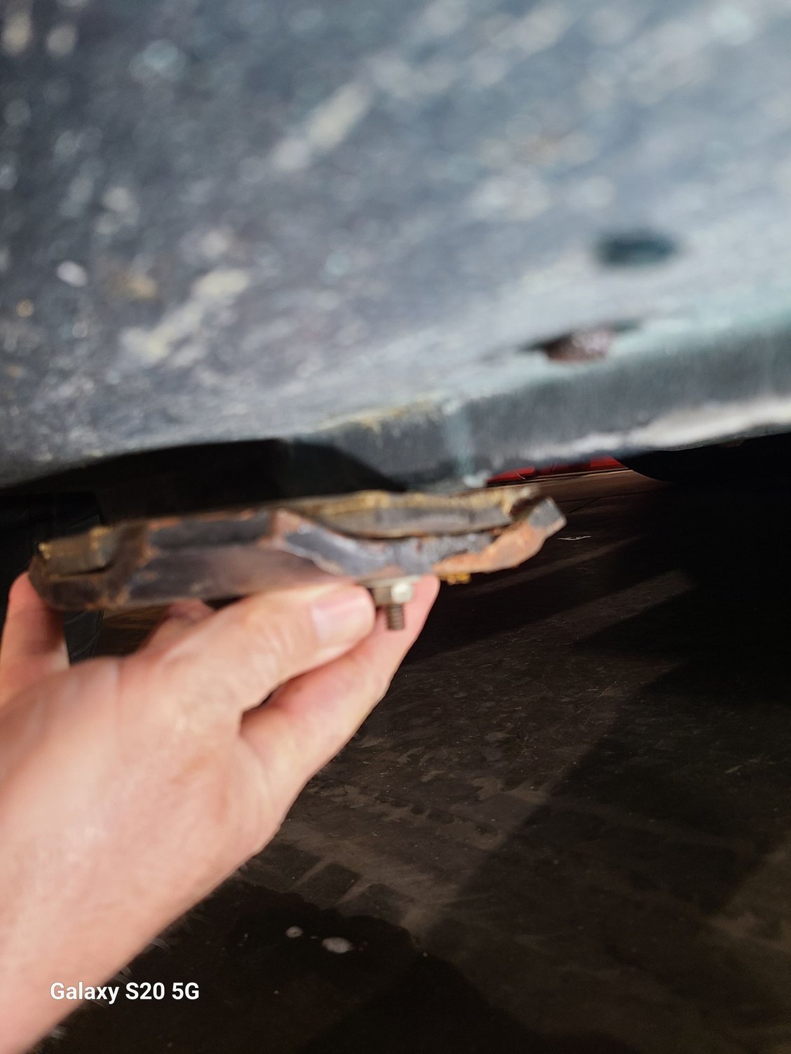

Motorcarman,
Would you be so kind as to tell me the best way to lift my xk8 on a two post lift. I saw your post above but for the life of me I can't find anyone actually showing where to place the pads when using a two post lift. I recently installed my lift and have so far only used it to lift my xjr6. That was rather obvious. I just got it in my little shop today and was planning on having a fun friday nigth working on the Jaaaggg. I have other things I can work on but damnit man I wanted to get it up in the air and have a look around! Thanks in advance for whomever can help. Eddy

There are FOUR reinforced metal sections welded to the 'pinch-welded' seams under the car.
They are obvious if you look closely.
Look to the rear of the front wheels and forward of the rear wheels.

Thank you so much for the reply. Just to be clear, you are saying I can put the pads on the reinforced pinch seem areas exactly where you use the roadside jack. I'm attaching a picture.
