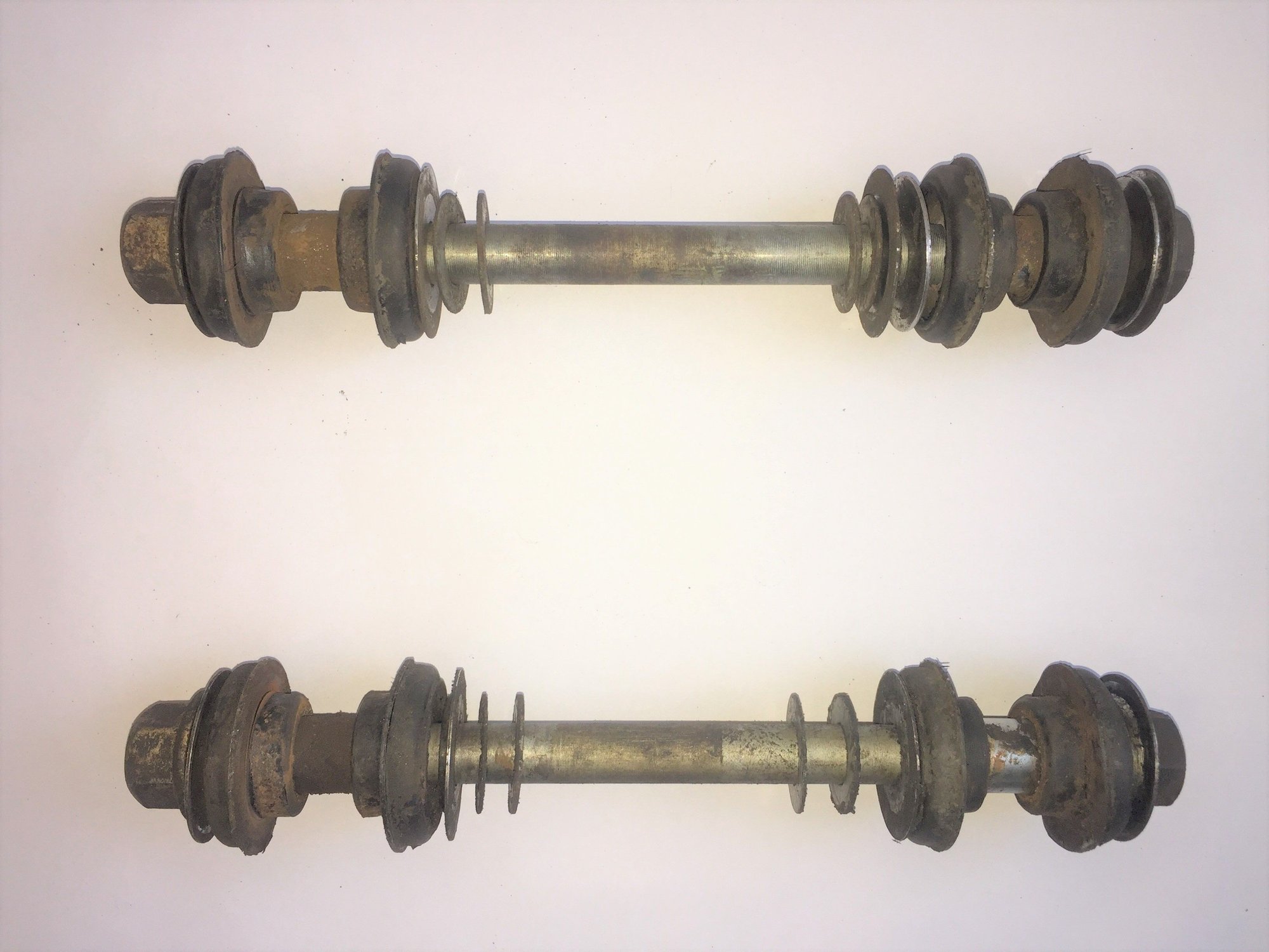

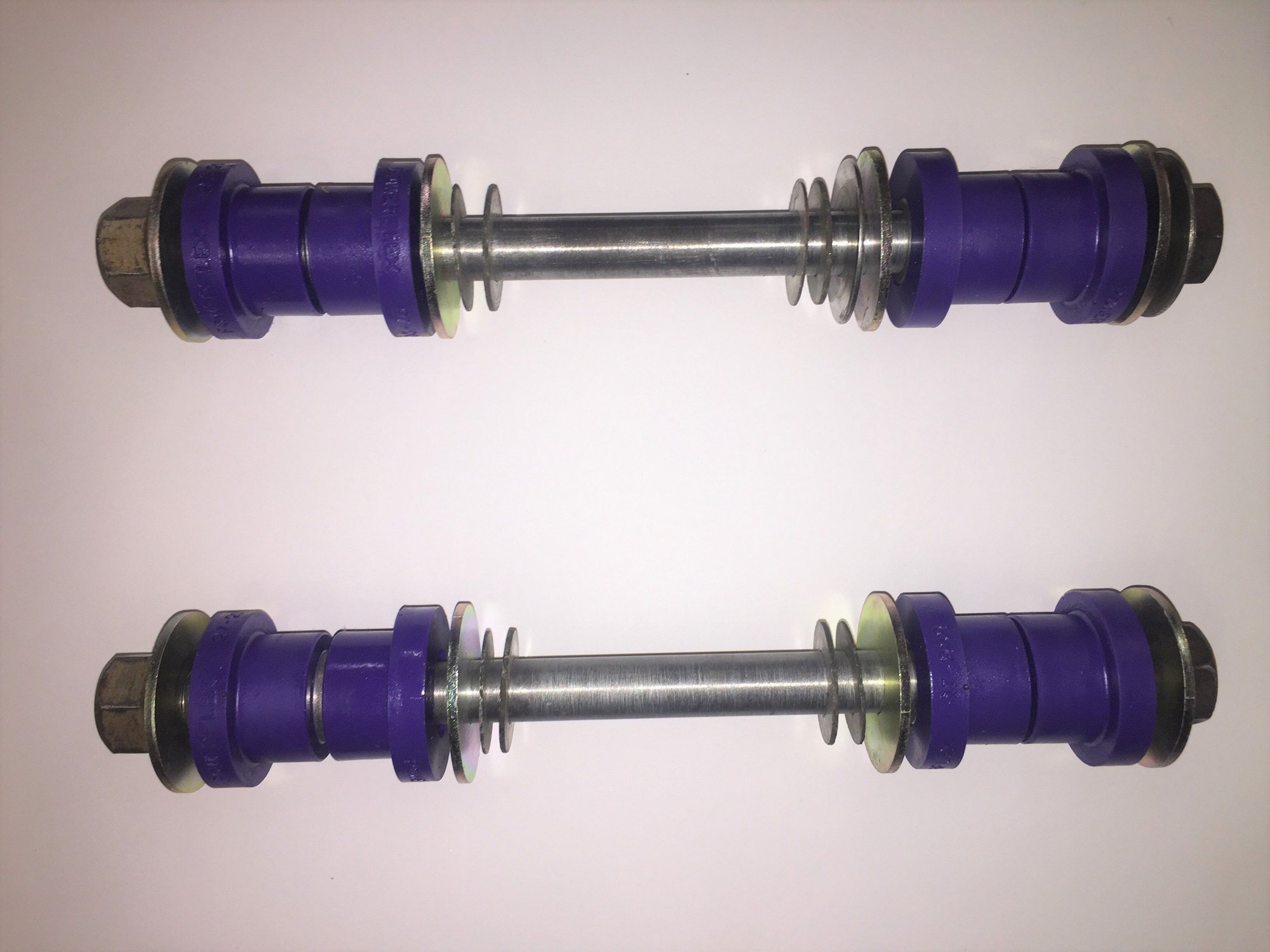

Yeah that is a total rip-off price. Powerflex poly bushes are $125 on ebay for set of four!
Are you sure you need new pins? They usually clean up pretty good. See mine before and after.

'Nough said right there. Just 'cause it's a Jag doesn't mean the prices have to go through the roof. I'm kinda wishing I bought the Powerflexs but it's done and I will never need to do them again. On to other areas.
