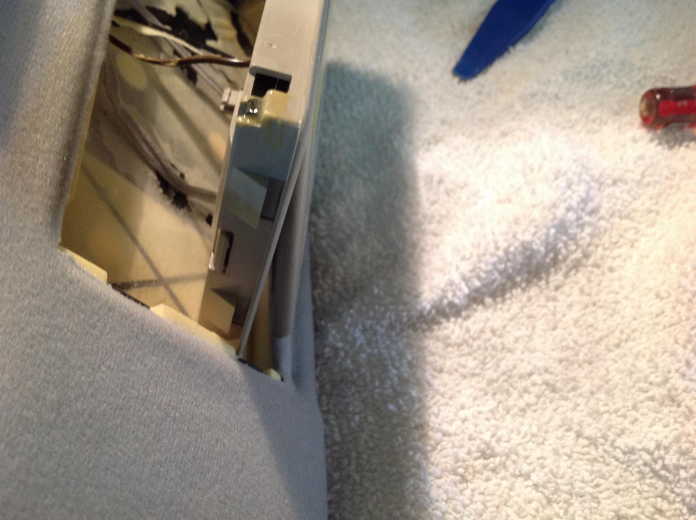

Quick comment about Gus's instruction:
Just repaired my passenger side mirror and on my 03 the mirror does have the clip in on the back but it's also held on each side by tabs that fit inside the sun visor. The two back clips did not appear to hold anything. To remove it just flex the sun visor, hold on each end and bend in the middle with the mirror side up. The side tabs will disengage.
Thanks Gus for the instructions

Jandreu, nice tip on the flexing.
I'll remember that when I do the passenger side (driver side is done).
My tabs look the same as yours.
