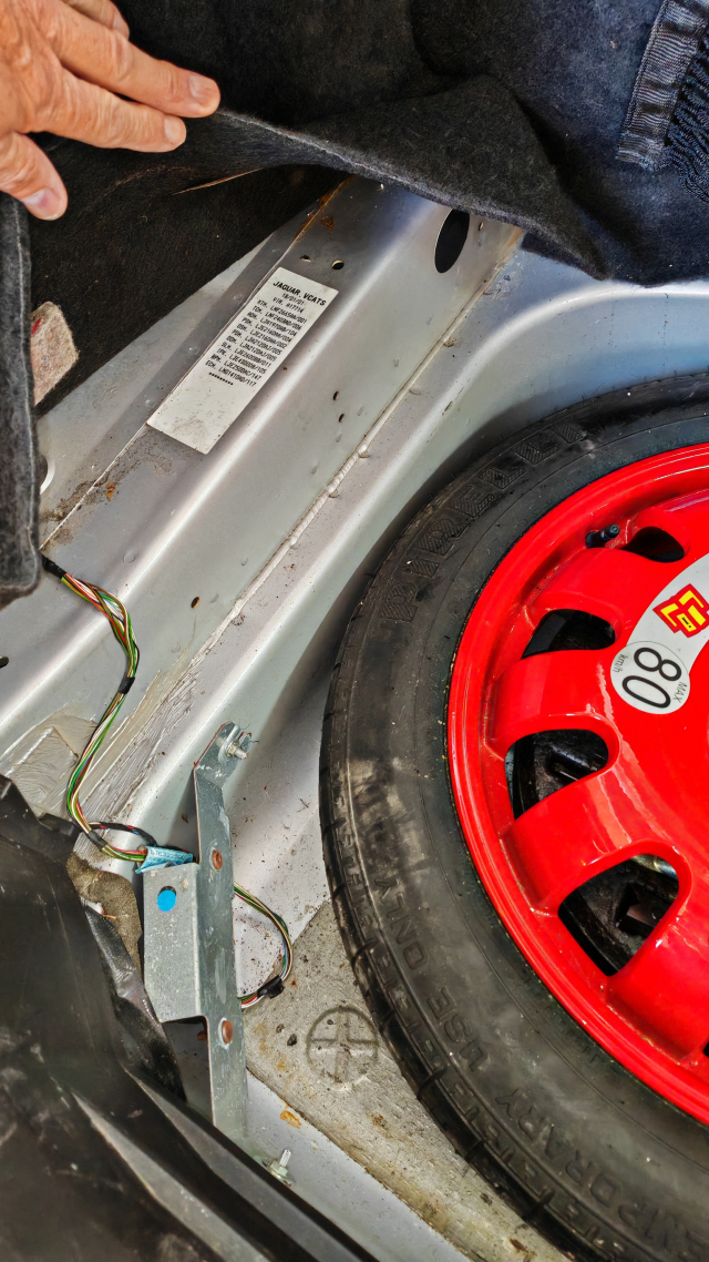

On mine it's under the carpet on the left side of the boot:-

Thanks for the photo, I found my label in the well directly under trunk latch....makes me wonder if the workers were just doing random placements just for fun....
