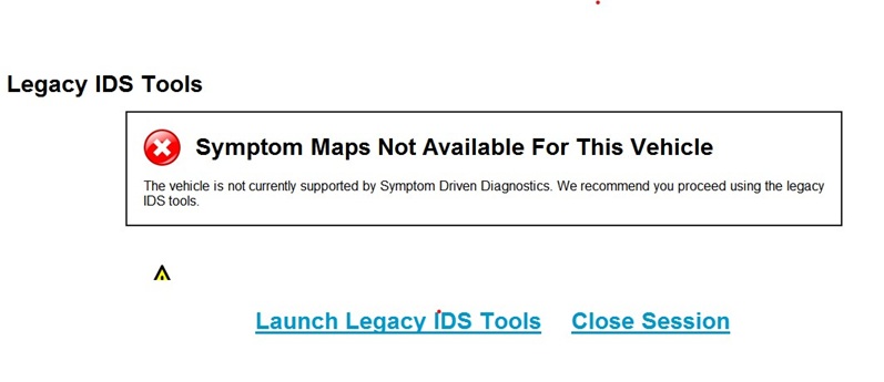

WDS was the first? incarnation.
Then along came IDS, later updated, with a web browser interface, and renamed SDD.
Version 130 will fail back to IDS (which is still there under the covers) if it is presented with an older VIN. I'm not sure where the VIN break is.
If I type in my '98 VIN at the start of a session, SDD tells me that it doesn't have symptom maps for my dinosaur, and offers a link to 'legacy' IDS. See attached.
Your 2004 is fine and SDD should read the VIN automatically.
Either IB has been screwing around with this editor again or I'm losing the plot - it won't let me post inline images

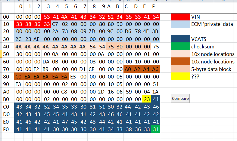

OK so I spent some time trawling through the VID block, with the assistance of TSB 1-186. FWIW, the data location text for illustration 3 is incorrect.
The 190-byte ‘Mirror data’ contains two separate blocks of 10 bytes each, which are the ‘node’ locations. IDK why they are separate and interspersed with the data.
A node with a non-zero value contains the network address (SCP or ISO) for a specific module – e.g. Node 40 (64 decimal) contains hex ‘4A’, which is the SCP address for the SLM. Each node relates to a 5-byte data block.
The restoration data tallies with the VID block contents, so I imagine it’s just read from there and repeated. It would be helpful if jaguar hadn’t mixed hex and decimal notation, though...
ECM_SYSTEM_A : Block[0] Size[64] * not backed up in VID block CAN address 0x7E8' I’m wondering if this is the VCATS code.
There are no free node locations (although 6 free bytes), so I suspect that ‘ * not backed up in VID block’ means just that, rather than the data is missing.
Onward and upward. It’s academic until I can verify there’s no corruption, other than the apparently orphaned value ‘23’ just prior to VCATS code, although the data isn’t out-and-out garbled.

Well done for decoding all that so far, this really emphasises how much you need a working VID block to compare it to.
One thing you could do is, in SDD, try changing a configurable option and then see what has changed in the VID block. You could do that with options that should be stored in the SLM and see what happens. Health warning: obviously this might cause the whole thing to explode, but non working is still non working, no matter how many pieces the car is in.
I wonder if that stray 23 is another checksum and I wonder how robust the checksum is? Maybe try adding everything up in the spreadsheet and see if the first byte is 31.

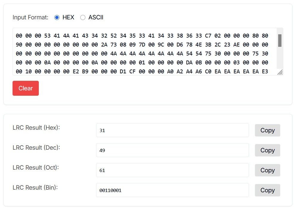

I'm not quite ready to risk programming at the moment. I have a couple more checks to do (exciter ring & the download SDD wants to do). I have a cheap 50A PSU that should work as a maintainer. But the clone Mongoose...
I was also wondering about this, so I've tried a couple of online calculators. Turns out to be an LRC checksum:
LRC Knowledge
LRC (Longitudinal Redundancy Check) is a data verification method that calculates the two's complement of the sum of all bytes.
Features
• Simple calculation: Addition and two's complement
• Better error detection than simple checksum
• Commonly used in MODBUS ASCII protocol
• Can detect odd number of bit errors
So, providing it is correct, the '23' byte is also correct.
Robust-ish, simple and quick to calculate, but nowhere near as good as hash algorithms.

That's good news about the checksum, although obviously to be 100% sure you need to check more than one data set. Assuming it is the correct checksum, that would mean if you can ever find a matching VID block from another car you could directly edit the non working VID block to match. (I'm sure you already know this, just thinking out loud).
I understand your caution about not wanting to risk breaking anything - I don't think I would be so patient and might instantly regret it.

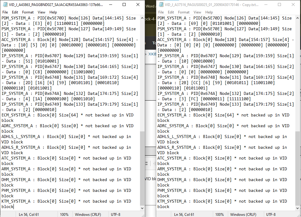

Well a quick look at LMG's file (on the right) shows the same "missing data" as in Michaelh's VID block (on the left), with nothing significantly different - lots of "not backed up" entries. Interesting differences in the SLM data.
I'm surprised how limited the VID block is.

OK, so that pretty much confirms ' * not backed up in VID block’ means 'this data doesn't get stored in the VID block'.
The node locations for the module addresses seem to be consistent.
I've done a compare, and there are quite a few differences, as dibbit notes. Some are clear:- the missing
address in location 0x80, and its associated all-zero data means that LMG's car doesn't have the ACC module fitted (or isn't aware of it, QED).
Only 4 discrepancies in the ECM 'private' data - one of which I *think* is related to the ACC.
Some not so much:- SLM and IP. Further checking required.
I'm going to visit the car tomorrow and try to program the KTM 'as new'. Fingers crossed. If that fails I'll look to source a proper interface...

I just found a VID block screenshot from a 2003 XKR convertible in an old post, so I'll see if that gives any more insights.
Well, this is interesting.
I have the steering wheel controls for cruise control but, strange as it may seem, I have never once tried to engage it. I guess the joy of driving that car compels me to remain in manual throttle mode
Once the rains here stop, I will take it out and try it to see what happens.

OK, to round this off, I compared the VID block from this 2019 thread I eventually found from jyuu:
https://www.jaguarforums.com/forum/x...1/#post2055459
It's a very close match to the one in 'my' car with regard to the module data, and only 3 bytes in the 'private' area (also, the checksum is correct), so I've likely gone as far as I can to determine the VID block's validity without searching through dozens of them.
Many thanks to all who have helped.
