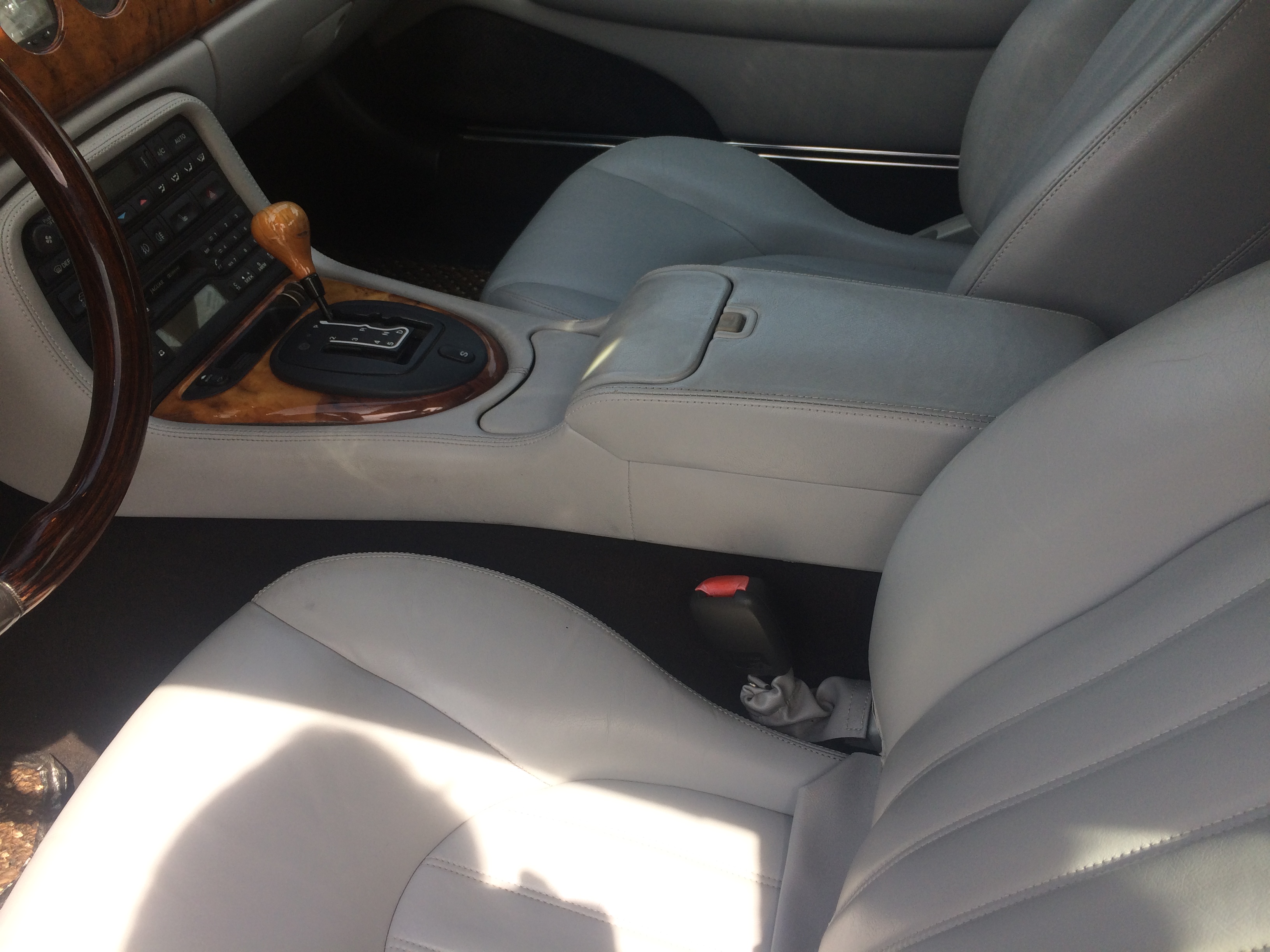

Been trying to decipher it for a while but my trim tag is missing on my 2003 XK8. The color of the leather seats and trim appears to be a light grey to me but can anyone tell me what is the "Official" color name and color code? Need to do some work and be able to match the exact trim colors. Hopefully the pics show up ok. Any help greatly appreciated!

It looks quite like mine. Mine is Cashmere.

Is the Cashmere the SDZ code? I've seen some online pics that make the Cashmere look more tan but that can be a trick of the lighting or filters. I had thought that it might be the Oatmeal ADG code but is that a darker gray? To my eye, it is a very light grey.
I have tried some online VIN decoders but they don't seem to get down to that level of detail. This one was originally sold in another state. Would any Jag dealer be able to find that info out? I haven't tried calling the dealer yet but probably need to anyway as I need the radio code as well.

I'd say: Ivory Leather, Sable Facia.

I agree with Paul.

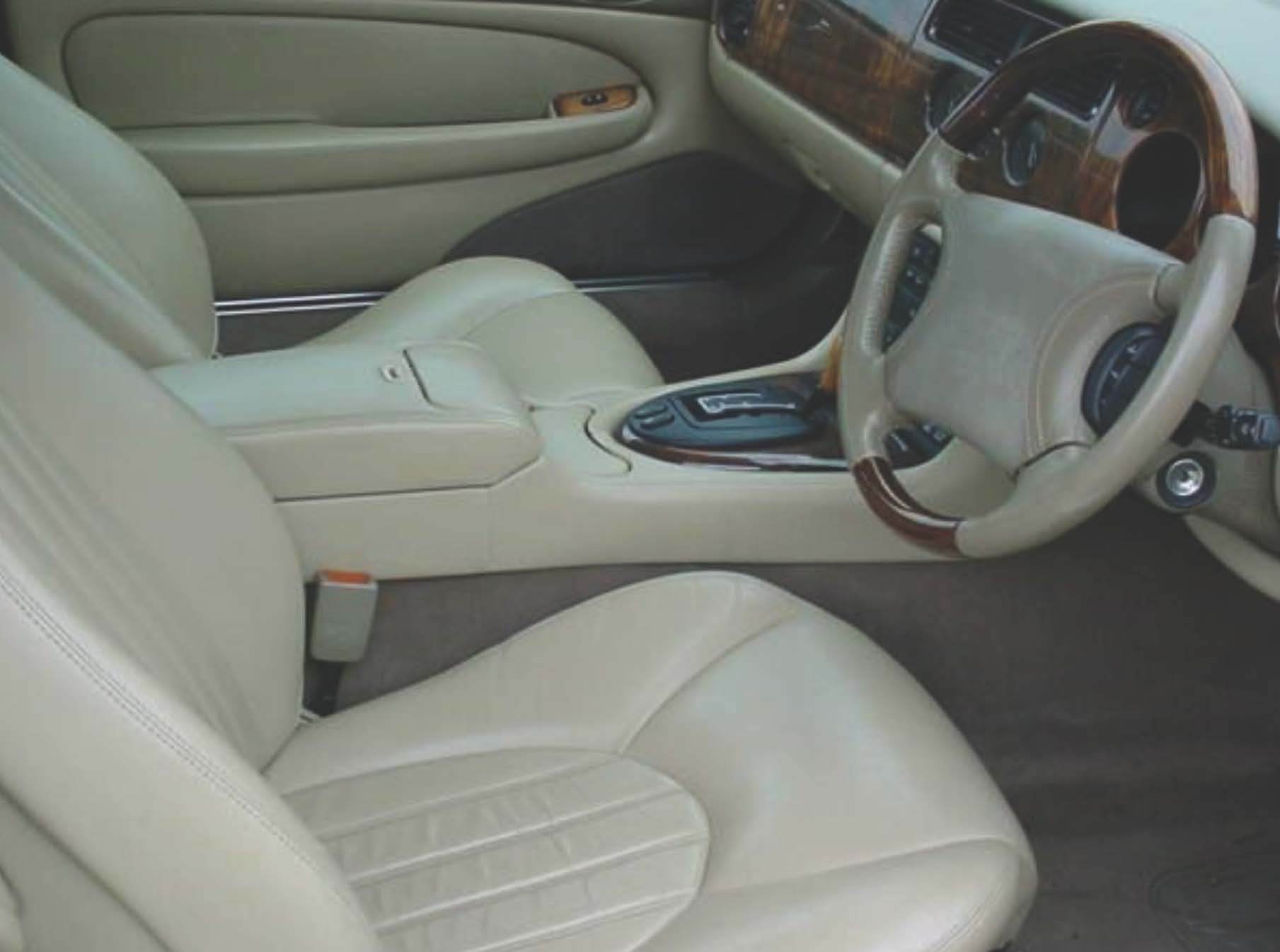

The brochure says that Cashmere is quite dark:
But as you can see from my interior that doesn't necessarily give the right impression:
Ivory, in my opinion is very bright bone-white, and oatmeal is much browner.
But your best bet is probably asking Jaguar!

Well thanks anyway Dr. D. It was worth a shot. I tried matching it up by color on some of the online leather restorers as mentioned earlier. On one the Dove looked nearly spot on but on the other it appeared to be a much darker gray. And I don't really want to rely on the color translations from the internet, since I suspect you will get variations between cameras, computers, screens and even lighting, not to mention what was actually input on the vendor side.

+ 1 for Ivory
