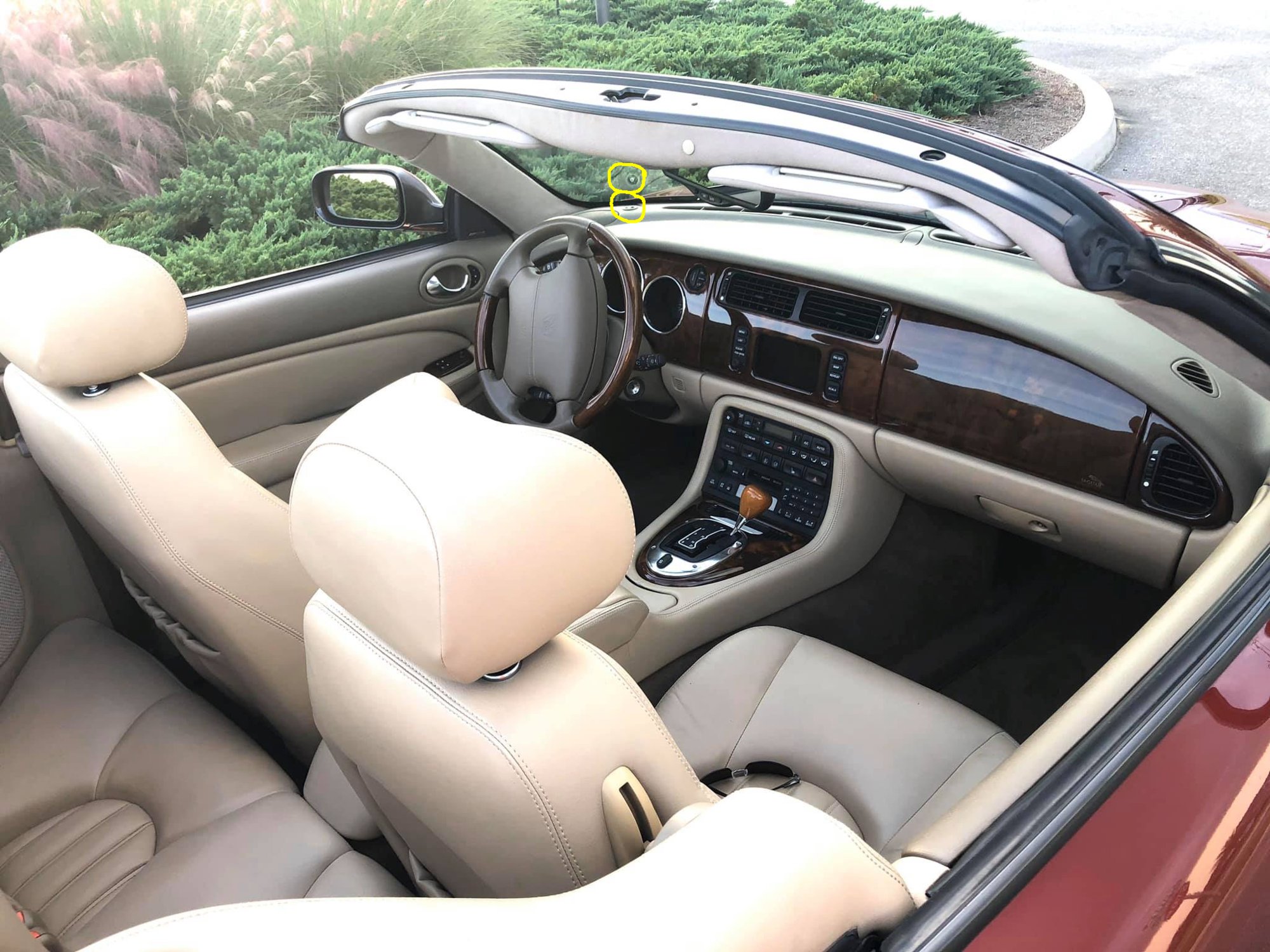

The first thing I noticed was on the top of the dash, slightly left of the steering wheel, there's what appears to be a light sensor. But it appears to be missing the typical black plastic dome covering. I'd like to get him a new sensor. But, from what I have read using Google, the light sensor is actually built into the rear view mirror? If so, then what is this ambient light sensor looking thing-a-ma-jig? Again, it's on top of the dash, near the windshield, slightly left of the steering wheel. I know what light sensor ICs look like and it certainly looks like a light sensor.

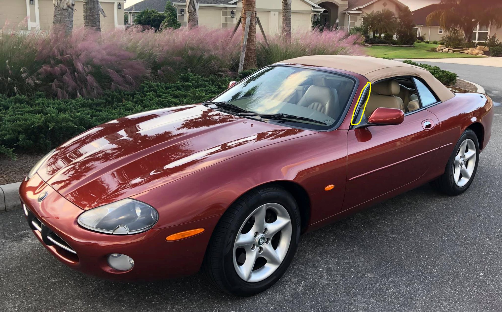

The second thing I noticed was a piece of black trim on the forward exterior of the driver's window. The piece which runs about 45 degrees from the bottom to the top. IIRC. It appears someone had at some point locked their keys in the car and decided to use a metal coat hanger to attempt to pry open the door lock from the inside. In this attempt they badly marred the paint on the trim. Is this trim available new? Would I be better off removing it, repairing and repainting it? The latter would kind of ruin the surprise of a Christmas gift. Not to mention, he'd likely tell me to not bother...it doesn't bug him. Anyway, if the piece is available for purchase, I'd like to find it.
Circled what I believe is the sensor (and its reflection in the windscreen)
This is actually the passenger side, photo flipped. Pretend this is the true driver's side and I am looking for the black window trim (circled).

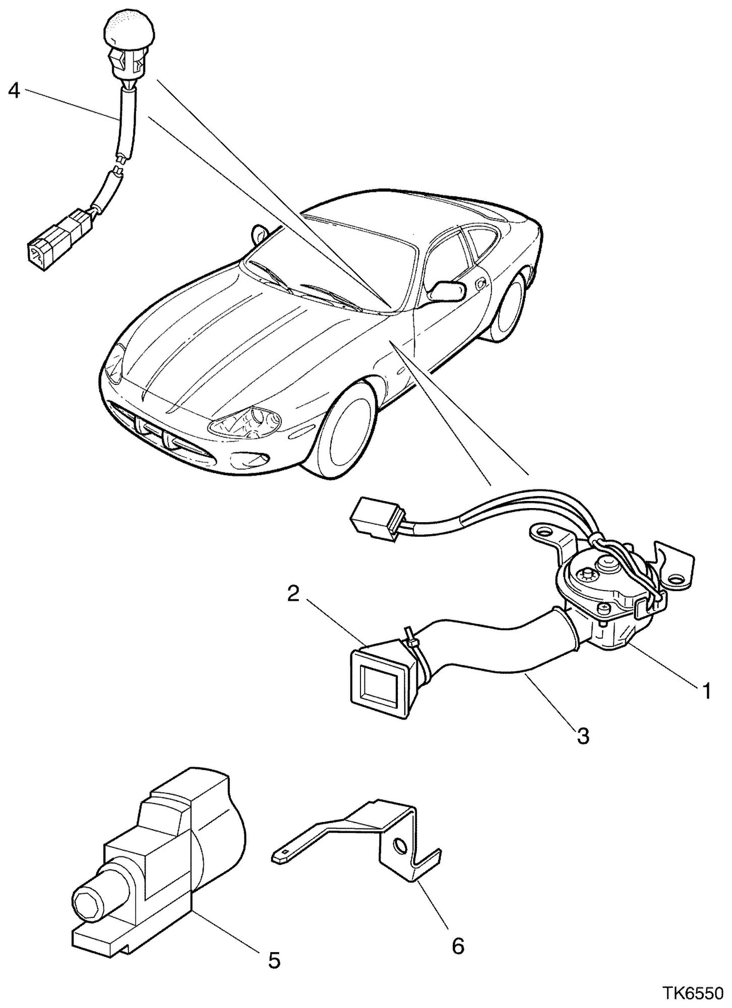

I believe the small part on the dash is the solar sensor, which provides sunshine information to the climate control system. It would be Part 4 in the parts diagram:
To find the part number, visit https://parts.jaguarlandroverclassic.com/
For the model, select the XK8 Coupe/Convertible 1997 - 2006 Classic
Refer to the VIN of your father's Jag to select the appropriate link, then select Air Conditioning /Heating/Ventilation > Control Panel and Sensors

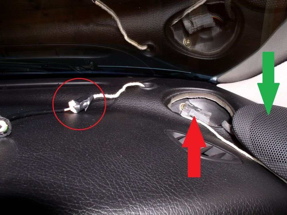

As Don says, it is the Solar Sensor. This dome cover was also missing on my 2005 XK8 Coupe. I couldn't source a replacement so got the whole sensor from a breaker. The dash speaker (arrowed green) has to lift out to access the harness connector (arrowed red) and I taped a piece of string to it to pull it through and the new one back.
The exterior trim is difficult to obtain and very expensive BUT can easily be refinished. The regular failure is the Door Waist Rail (the one along the top of the door) but the process is the same. this thread shows how K. Westra refinished his early Dorchester Grey trim and how I did my later Satin Black trims:
https://www.jaguarforums.com/forum/x...q-55561/page2/
