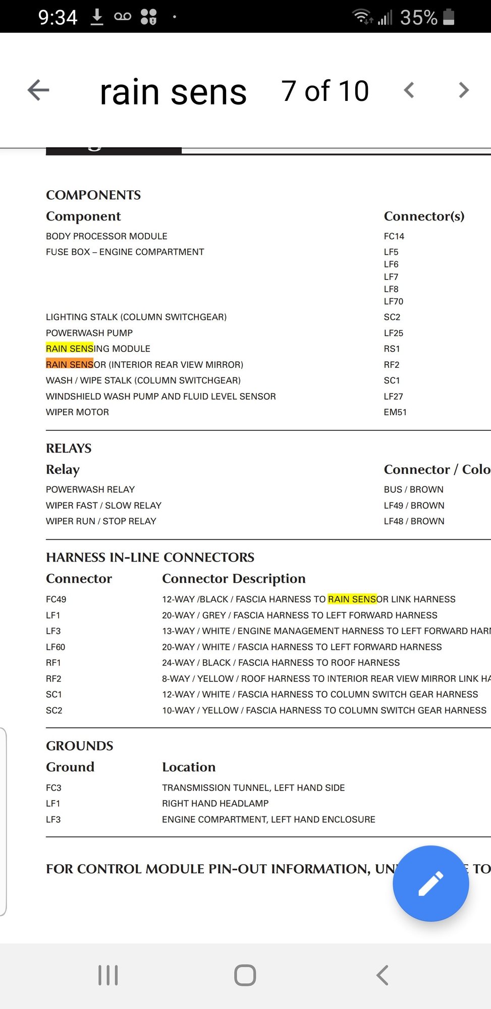

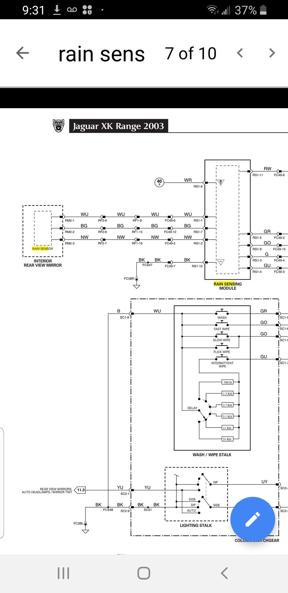

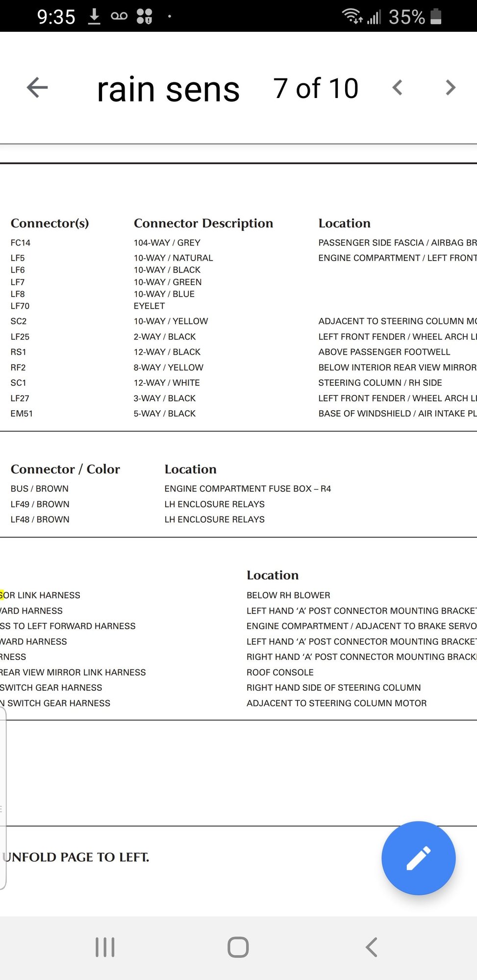

Rain sense module to mirror
Other side of page
Connectors and colors left side of page

Cyber3d, hope the graphics help. Sometimes it's a bit of a battle to properly post images like this. If I missed something or youd like a different view, just ask.
Interesting thing, 1998 electrical diagram has no reference to Rain Sensor. Maybe it didn't exist yet? This came from the 2003 manual.
I wonder if you have a loose wire in the mirror area.
