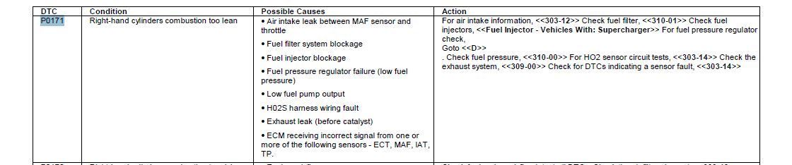

You info doesn't give the state you live in and there are different requirements by state. The odds are against you for passing smog with a pending P0171 code. The ode indicates you are running lean on the right bank. I have attached a copy of the DTC definition for the P0171. Since it is a pending you most likely have a small vacuum leak causing the code to flag.
