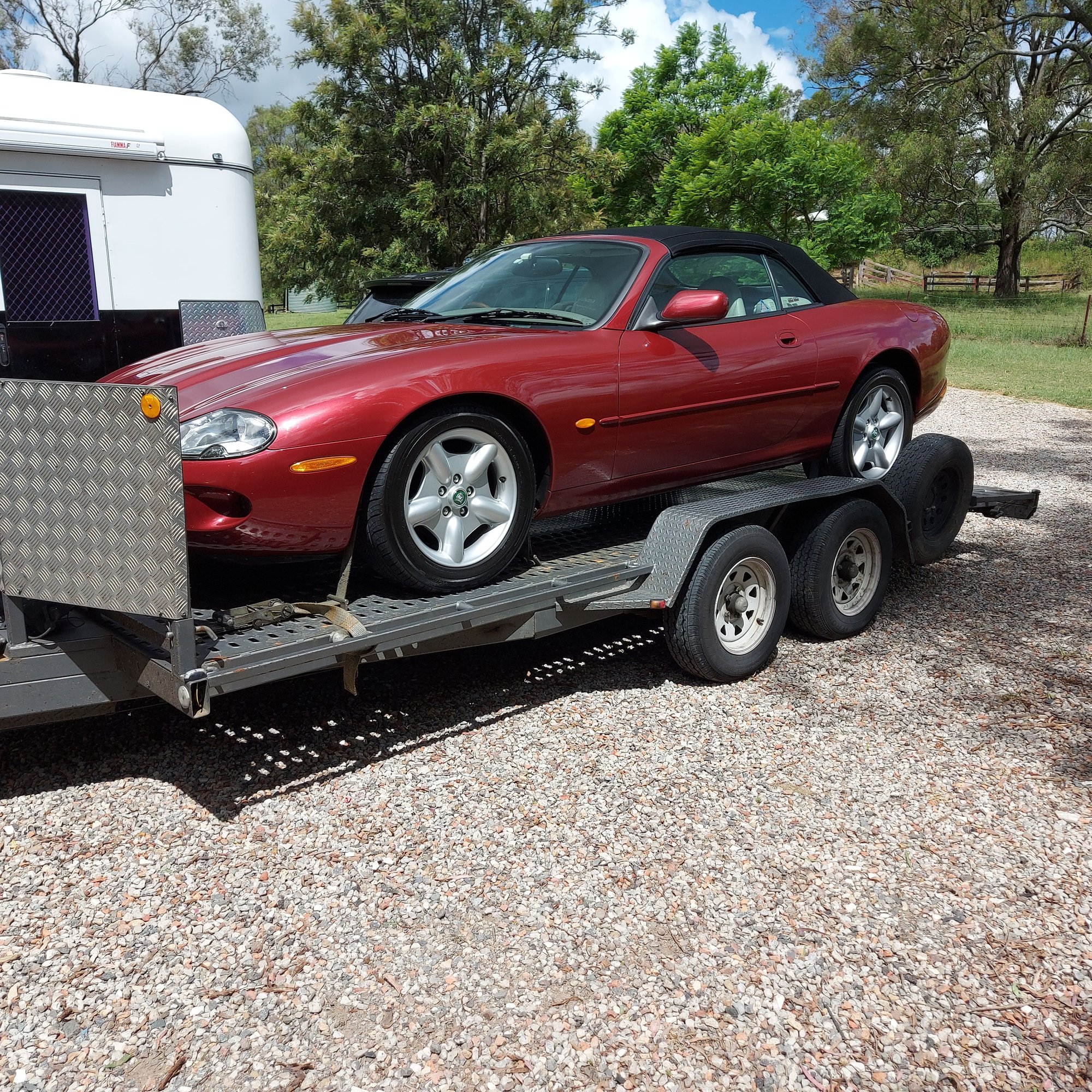

I would recommend using straps over each tyre if you can. I did this recently when I travelled 4 hours back home with my 98 XK8. It didn't budge an inch. Also put it in neutral to take the strain off the transmission. Unlock the gearstick through the small hole in the gear shift
plate probably closed with a plastic crosshead plug then select neutral.
