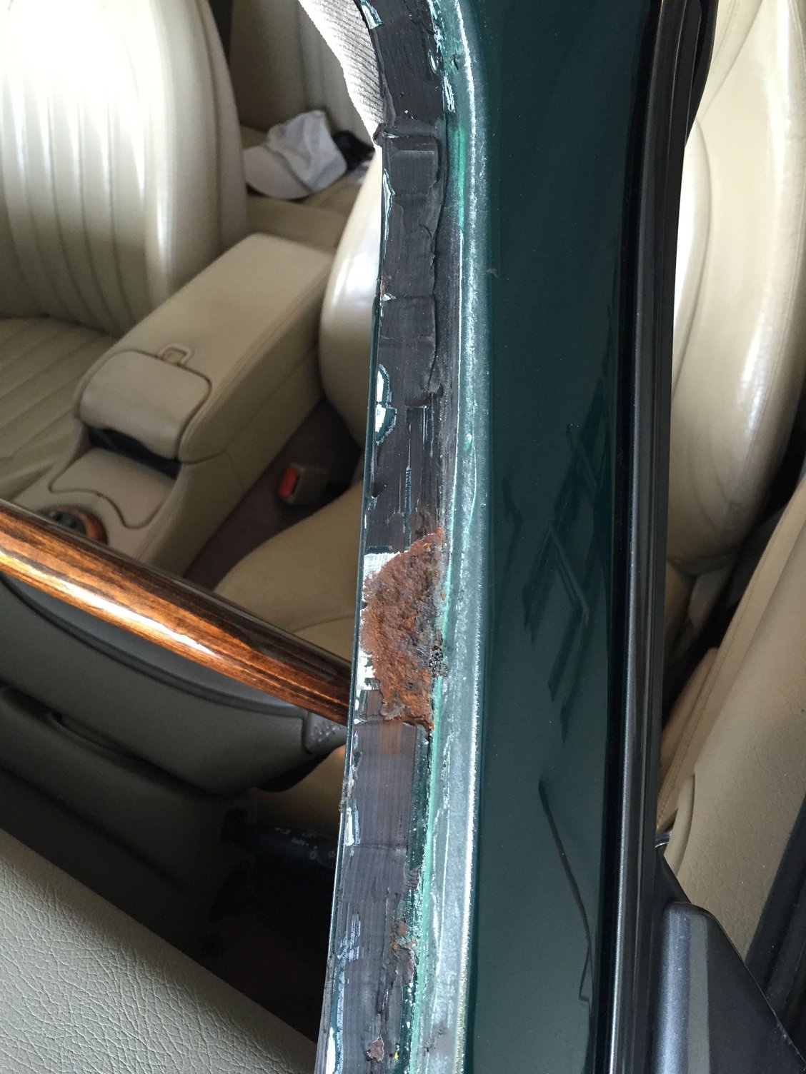

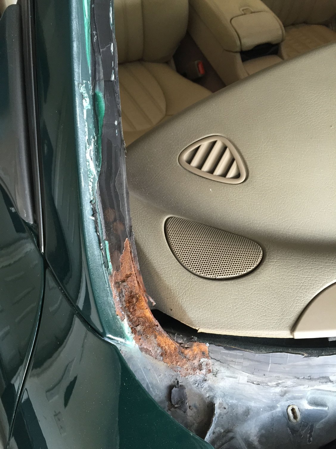

I developed a crack in the windshield a few years ago. I took it to Safelite. Had a great tech who took out the windshield and found rust was the reason for the crack. They don't do body work. I had to have the car towed back home.
I had to fix this.....
And this..
After I fixed the rust, they came to my house and replaced the windshield. They did a great job.
