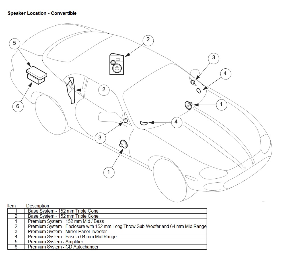

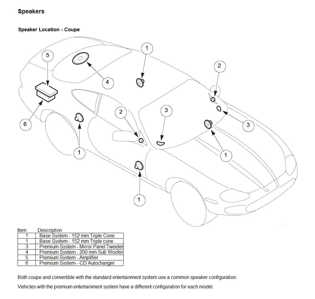

Here's the speaker description for 1997MY from JTIS:
(click on the images to enlarge them)
Model Year and body type are essential information for a question like this. Please add vehicle details to your forum Signature.

The INTRO to the XK8 booklet (MY 1997) has the section on ICE and apparently the base model uses the 6.25" triple cone as the door speakers AND rear quarter for the convertible. The PREMIUM SOUND has the 'long throw' subwoofers.
Sometime later the rear speaker box was upgraded to 2 speakers for greater range (as in GGG info sketch)
The MY 1997 intro guide is in the large file area for download and all this info is in there. It is over 24 megs so I cannot post it to this reply as an attachment.
look for
XK8 Intro_jjm18151470.pdf
sorry for the mis-info if you have the BASE model.
