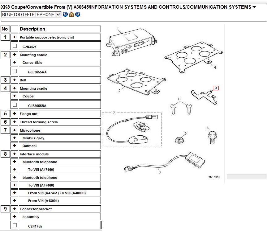

Unless you have a 4.2-S which is fitted with Bluetooth as standard, then Bluetooth would have been a very costly option for the first owner.
If you are considering retrofitting OE Jaguar rather than an aftermarket alternative, this should not be too difficult as the vehicle will have most of the harness already fitted.
The problem will be sourcing the PSE Unit (Item 1) and Interface Module (Item 8).

From the draft I'd guess the interface module is taking the place of the phone receiver, isn't it?

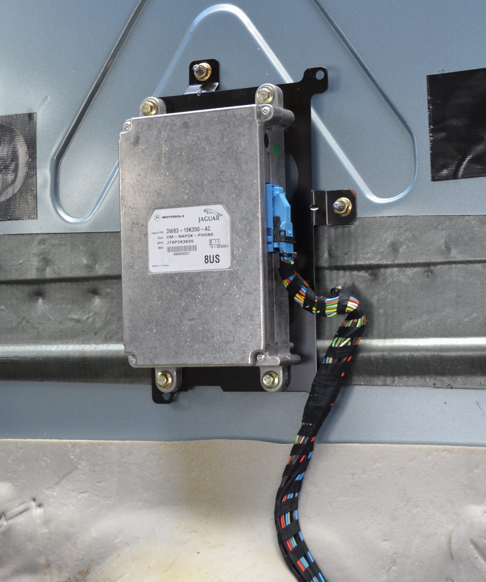

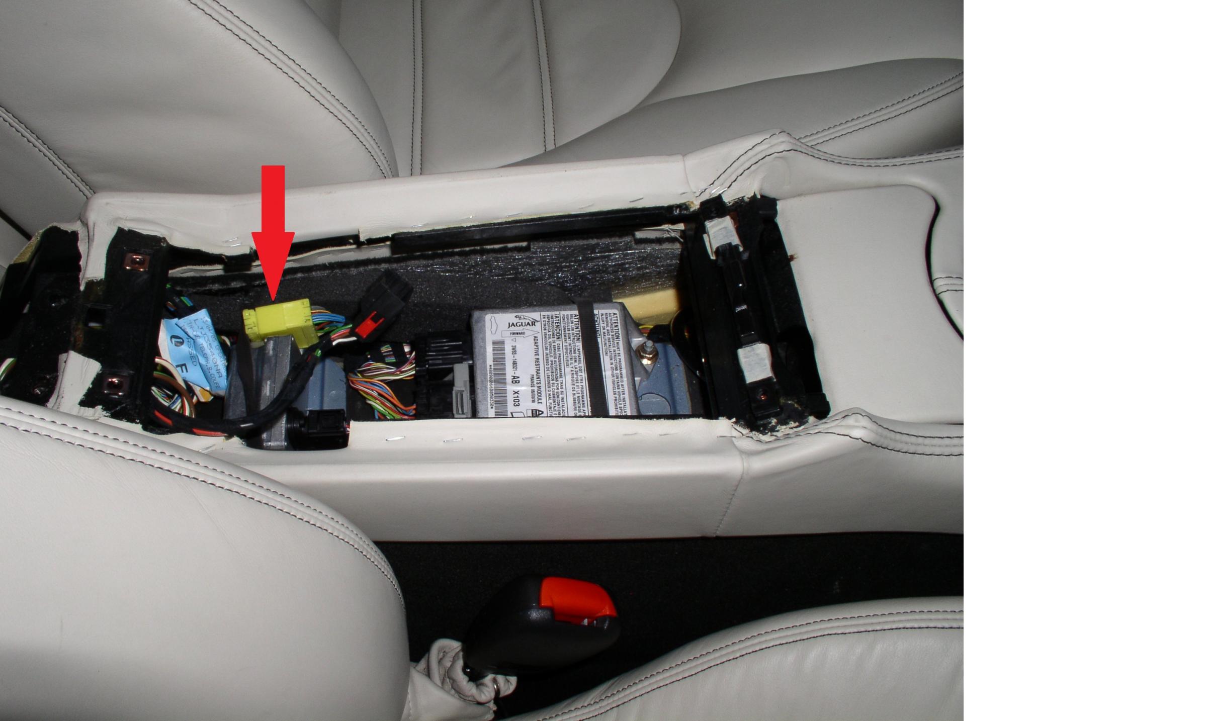

The essential for a straightforward upgrade is having the telephone harness already in place and I'd be surprised if a different harness is fitted to BT and non-BT vehicles.
The easiest way for you to check is to see if the harness with the blue connector for the PSE Unit is behind the rear seat back:
Also that the harness with the yellow connector (arrowed in red) for the Interface Module is under the Centre Console:

Thanks for the pics - my car has all the wires in place but you are right: the cost for the upgrade is ridiculous! Jag dealer quoted mit € 1600 for the PSEU (C2N3421) and more than € 800 for the interface module (was C2N3689 and is now C2S49706).

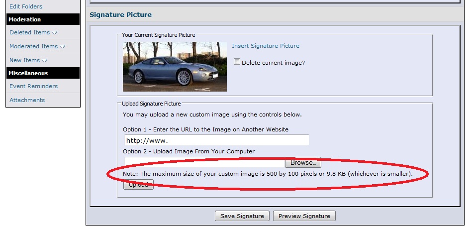

Oh yes, how do I put a 'garage' picture in my post .... Like you and other members have?
Regards,
The bracket for the PSE appears to be for a coupe, is it? Is the PSE mounted behind the gas tank inside the trunk or behind the rear seat inside the car?
Is the Bluetooth module located inside the center console? or is it somewhere near the PSE? Do you happen to know how the harness to the PSE runs?
