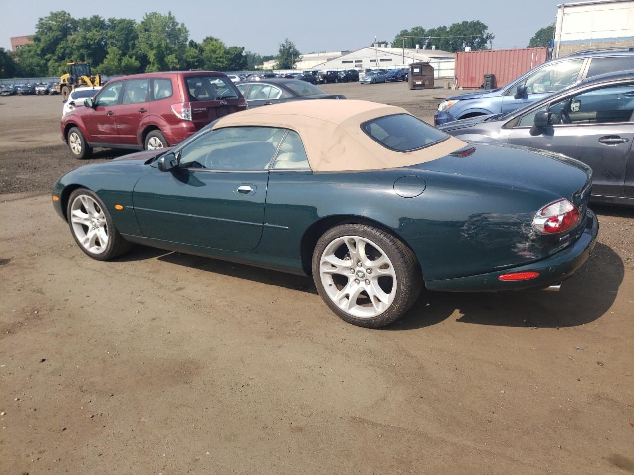

Hi guys! I apologize if this has already been mentioned somewhere... I searched, but I couldn't find the specific difference between the 4.0L and 4.2L model lines. I've been considering buying a newer Jaguar for a while now. The choice was the six-cylinder F-type, but in the end I'm coming back to the idea of ​​staying loyal to the X100, which I like better. I found an offer for a 2003 XK8 with a 4.2 engine, 70k miles. Imported from the USA, guaranteed - never crashed. The color is exactly the same as my current 1999 XK8. I already have a copy of the US Title. I'd like to know what to look out for with the 4.2 model, or how to find out if the car has been in an accident. Simply, what to check technically... so that I don't spend months in the workshop again, like with my current XK8. I know, there is a "better" six-speed ZF transmission, no need to worry about nicasil, timing belt tensioners, the thermostat tower has already been replaced, the headrests do not work (I have already watched the repair videos). Otherwise everything works, no warning light! Are there also problems with shock absorber mounting like in older models? I solved it with my XK8 by mounting it from "Baxtor". Which works great! Please advise me what to ask the seller and what photos to request, even before I send him a deposit? Is it possible to find out the crash by VIN? (It doesn't work very well in the Czech Republic). The car is already in the EU, but not in our country. So I can't see it in person. Thank you for any advice. This forum and the helpful people on this forum are a great help. Thanks for everything!

I already found it by VIN. Fixed a minor scuffle...This defect - damaged left rear fender and lamp. That's fine. Other sides ok.
