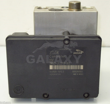

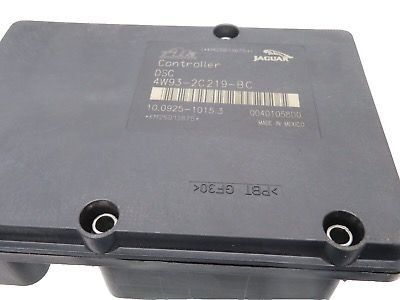

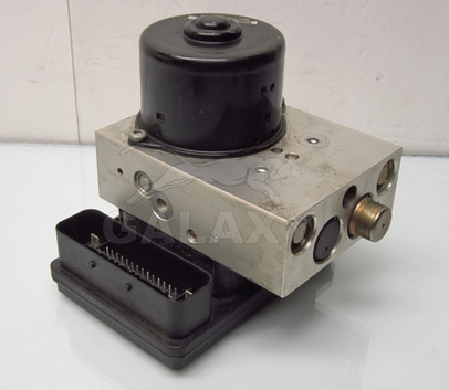

I know the 4.2L is different to the earlier ones- does it look like this:
Pics pinched from t'interweb. It is Jaguar part # C2N3651.
I've not read of any soldering failures on the 4.2L modules. Perhaps the rearranged connector layout has improved things?
Amazingly available new if you have a spare kidney...

Here you go. So do these experience the same solder joint power connection issues as the others?
