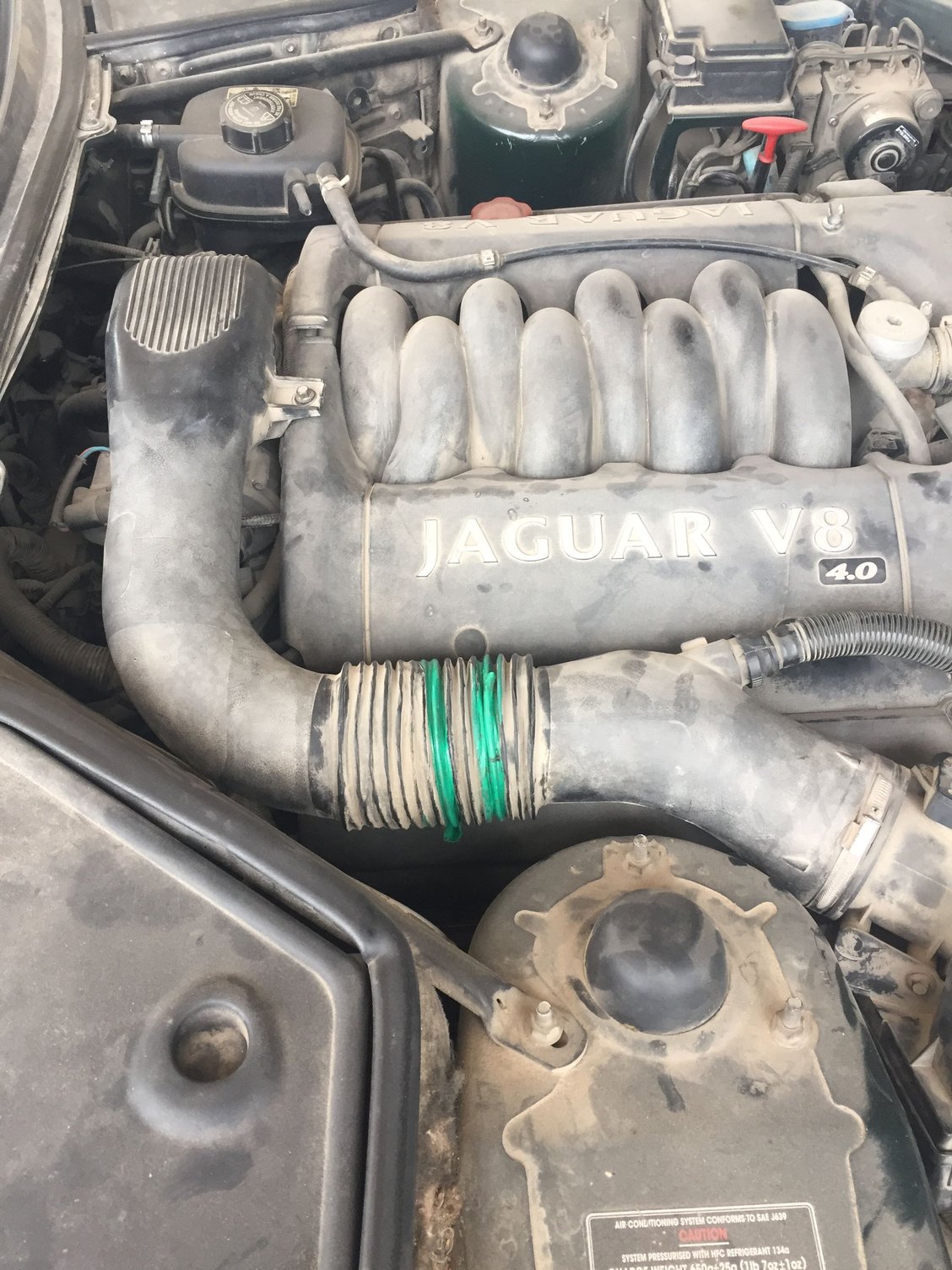

First thing is to open the bonnet and check for air leaks. See pic below for a possible common culprit.
I’ve had tape up the air tunnel accordion section many times ( green tape in the pic).
