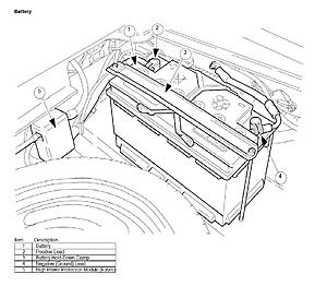

Have you checked the cable connections at the High Power Protection Module (see item 5):
These are known to loosen or even start to break up resulting in the symptoms you describe.

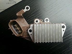

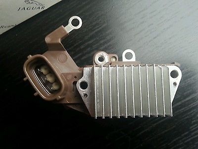

The Jaguar manual lists a voltage regulator JLM20187 but I cant seem to find this anywhere near the alternator ? ? ? ? I have a picture of it but cant find it on the car. Could it be an issue with the starter or solenoid as everything else on the car works fine but it just wont start ???

The voltage regulator on the car only falls into place when the alternator is charging so for the moment put that on hold. You say the battery is only providing 13v at the battery after it has been fully charged and if that is the situation I would take it back and have it replaced. As a personal note I recently had a new battery replaced two times because of internal failure.
I would however, check all your connections from the main battery and the High Power Protection Fuses.

First, I'd check the connections in the high power fuse protection box in the spare wheel well - the box that the positive lead from the battery goes straight to, Loose connections here are not unknown and will cause the sort of voltage drop you're experiencing.
