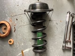

Hey Wayne I know you just completed this job as I did a few months ago. I really didn't find this job that difficult because I used two tried and true methods that do work and make this job a lot easier.
First, Just follow Bobs (Motorcarman), way of removing the 4 bolts on the steel plate that's bolted to rear suspension and pry it down to release and re-install the rear shocks. Brilliant, they drop out lol
Second, was something I saw on Rothwells thread a while back and it made the job a lot less frustrating and it worked very well.
Put it all together and zip tie it. I liked doing it this way because I could position and tweek the components as I wanted to and then know for sure that everything stayed were I put them.
Put it all together and zip tie it. I liked doing it this way because I could position and tweek the components as I wanted to and then know for sure that everything stayed that way. When you're wrestling these in on your back and have limited visibility you'll appreciate this tip!
As always, a big thank you to all those who have shared their knowledge and experiences to help fellow members.
