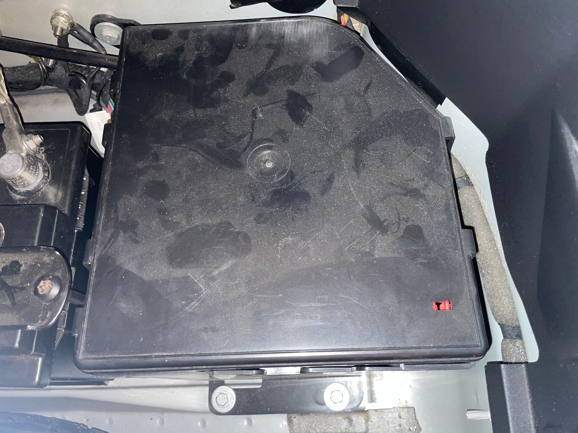

I forgot to ask - this is kind of a stupid question, but - the list of fuses in each fuse box doesn't seem to indicate which physical location in the car each one (in the list) is referring to... I thought that might be a starting point. Any other vehicle I've had simply has a diagram on the underside of the panel cover. Damn gremlins are such a headache!

There's a list of fuses here https://www.tothegarage.co.uk/services-1 for a 2002, but the same issue as with the manual - what is the relationship between the "fuse number" in the printed list, and where they are located physically?? The fuse locations in the car are not numbered, so when looking at "fascia fuse box - driver's side" (https://drive.google.com/file/d/1rIK...DeJ_BGH_1/view), fuse #7 (looks like a good place to start), I still don't know which fuse it is inside the car under that panel. I guess first I need to determine if they're referring to UK or US driver's side o_O
Check F7 (15A) in the driver side fascia fusebox.
Check F3 (5A) in the engine compartment fusebox if your front fogs also don't work/cabin heat is poor. The 'intelligent' sounder has a set of NiCad batteries inside that corrode and the module decomposes & pops the fuse. The 'fix' is to just disconnect as they're not available new and a S/H part is just as likely to fail (NiCads don't normally last anywhere near 20 years, although mine almost did).
edit: Jaguar used to print that on the lid - honest, guv - at least as far as 1998.
The fuses are numbered but you need 20yr-old eyes or a magnifying glass to read. Top to bottom, but if two rows then read top right for #1, continues to top left for the rest.
edit2: Just re-read and I see you've replaced the headlining. Not seen this reported on a coupe, but on the convertible, there have been cases where the sun visor screws have caused a short to the vanity lights on refitting. F7 is supposed to protect the BPM against this, but there have been occasions where it's killed the module. Be careful here. You can disconnect the lights at the connectors under the centre roof console to check for a short circuit.

Hi,
I'm hoping someone can offer some insight; here's the context and issue:
1999 XK8 coupe, was in winter storage since late October (yes we have long #$%#@%@#$ing winters where I am) with a trickle charger on battery till ~end of April (I disconnected it once weather warmed up, then we got blasted with more snow and ended up delayed till now so trickle charger has been disconnected for ~6 weeks or so). I also ended up ordering a headliner which took two months to arrive from the UK. Anyways..
I finally got around to ending the hibernation this weekend. At one point I tripped the alarm system, hit the unlock button on the fob and it quit. In my excitement I forgot I had taken the trickle charger off it weeks ago, and everything worked fine as soon as i connected the battery (ie nothing unusual indicated low charge), including starting up right off the bat. I let it idle and warm up and then, finally, with snow-free, freshly cleaned streets beckoning me from just beyond my garage door......... the shifter would not move out of park.
Knowing how finicky they are about electrical, I threw the trickle charger (I don't have an actual charger) on overnight, till it showed full charge, then hooked it up the next day but still stuck in park.
Currently: It will start up fine. No error messages or codes. Fob locks/unlocks and opens trunk as usual. Brake lights come on when I touch the pedal. The oddities, however are: no chirping with the lock/unlock (although lights flash once or twice as they would in sync with the chirp). Windows lower when the doorhandles are pulled up, but don't raise up again upon closing the door. No interior or trunk lights come on when doors / trunk lid open (except the lower corner light on interior of doors do come on).
I've found several posts about the shifter solenoid needing replacement, and/or the cable coming detached, and/or the brake pedal switch being shot, as well as temporarily unlocking shifter underneath torx screw.
Wondering if this is related to either: the alarm system? Or, battery actually isn't fully charged in which case I'll try boosting it with my truck??
Also worried I may have jammed the fob buttons out of habit, as my daily driver is an older Ranger that requires a bit of abuse to operate properly lol.
Thanks in advance!! The year is half over, would really like to go for a spin!!
