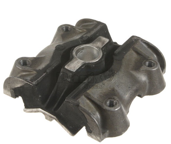

Well, perhaps my "Square" description wasnt accurate.
But it looks like this:

Sorry... I missed the gist of your question. The subject items are the subframe mounts. They attach the rear of the aluminum crossmember to the unibody frame rails. The crossmember supports the engine as well as the front suspension... So yes they are an important part.
The four smaller bolts attach the mount to the subframe and the center larger bolt attach the unibody. The rubber holds everything together.

Ah! Now I get it. The Front Crossbeam Vee Mounting (item 3):
Jaguar used to fit metalastik Vee mounts on earlier models. These are prone to de-laminating, in the worst case ending up with metal to metal contact between the body and the suspension resulting in transmitted vibrations.
The XK8/XKR Vee Mountings are an alternative design to try to remedy this failure. Instead of metalastik, the mountings are gel filled. They last much longer but can fail with the gel leaking out.

I am looking at a spare crossmember right now in my garage. The rear 'vee' crossmember mount is not silicon filled. The center mounting hole is bonded to a section of solid rubber cushion about a half inch thick. This is rubber is then bonded to the perimeter 'square' section containing the four bolts which join it to the crossmember proper.
The front round mounts might be silicon filled, but not the rears... it is plain to see they are solid rubber. Regardless, we are splitting hairs here... they are a critical piece on the car, and if they break, there will be fearful noises, probably some vibration, and lots of gnashing of teeth going on.

I knew there was a reasonable explanation, and this explains it all now.
The front ones look decent. The rears are far from it. Although there's No strange vibrations that are out of the ordinary yet. I will bite the bullet and toss more money and parts into it.
