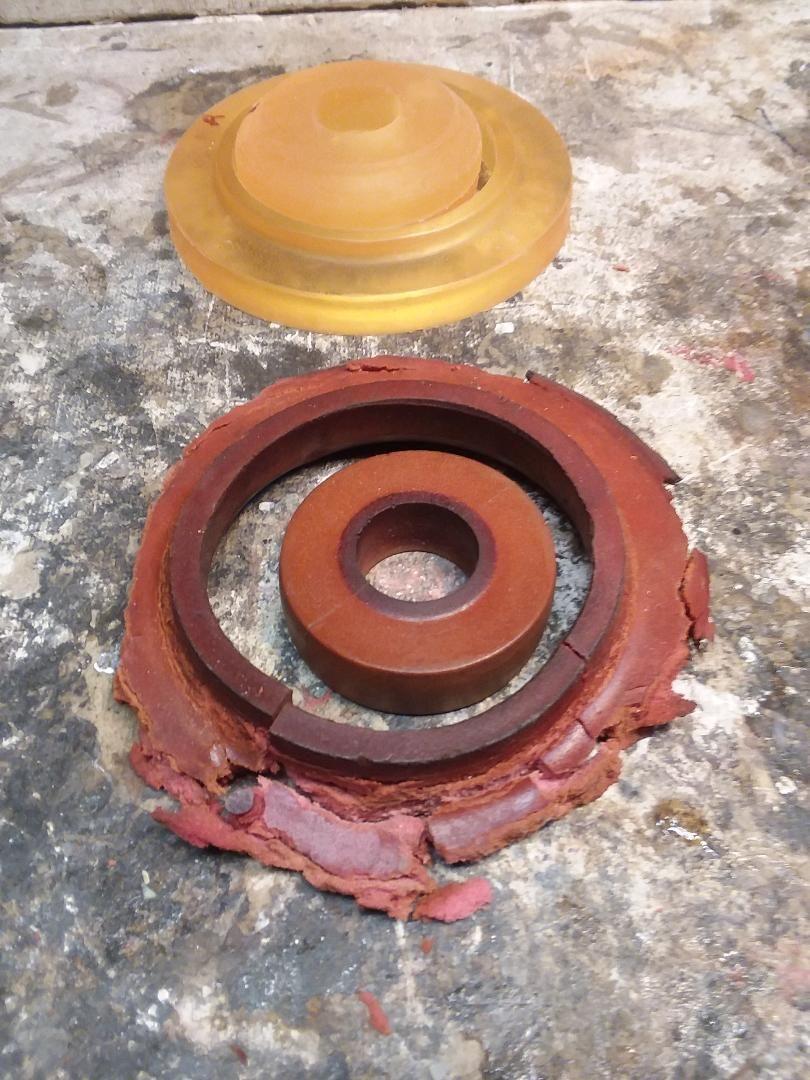

This is probably what the inside looks like. I've just removed these from my 98 XK8.

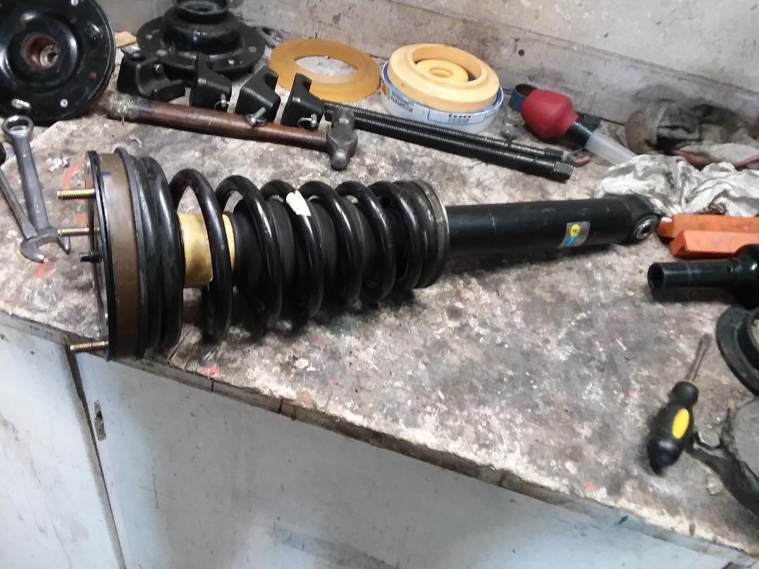

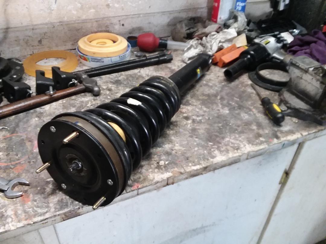

I did replace all the bushings and ball joints. Everything is as tight as it can be. What a difference!

I would say that just about everything was original including the bottom shock bushes. As the car will be a sunny day and Sunday driver, I would say that these new parts will see me out.

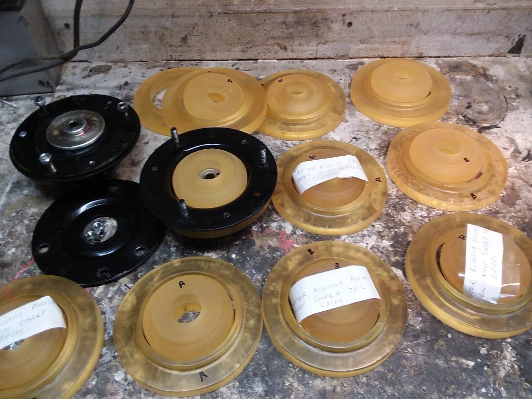

I went through the whole drama of replacing my top shock mounts with the only option we have here in the US the URO mounts, only to find that when I hit the first pothole the fabric inside the mount collapsed and the whole thing started to rattle! It was then that I decided to make my own! I found the perfect POLYURETHANE flexible material, made some molds and now I ship them all over the world. These parts are a permanent, perfect, solution to the problem and mke a huge difference to the way the car handles!
