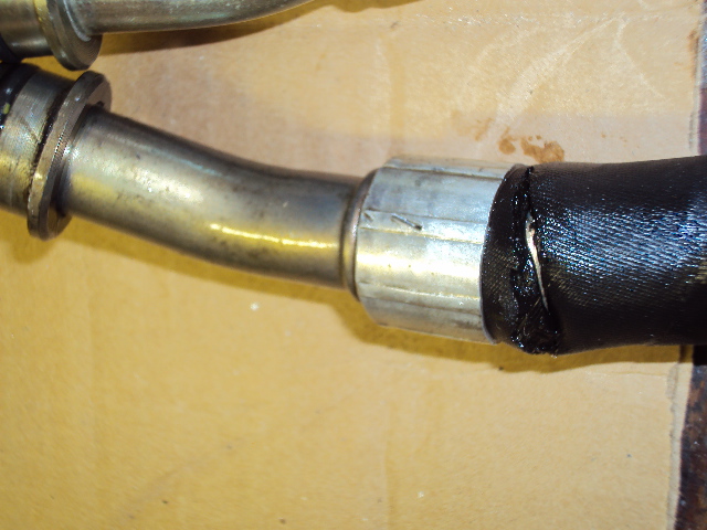

Check the oil cooler in front of the radiator, it hangs low and you might have snagged a line on something.

Jaguar makes a revised hose that a lot stronger than the original
Removal of the lower cover is usually held on by screws or plastic rivets.
The process is not too hard to me, just put your car up or jack stands and get er done, don't forget to add oil lol
Replace all hoses that are leaking, unless you find something else

Or remove your old lines,take to a hydraulic hose company or ship it off, let them make a much more improved design over jaguar for a cheaper price !!!
Be sure to insect the hoses that the return and feed line go to as well
Mine showed minor stress cracks, I put 5/8'' hose clamps on the ends with a piece of silicone hose, so if they rupture before I get to them, it will only leak and not ruin my engine until I'm ready to replace them soon.

That diagram is of the power steering oil cooler.
The engine oil cooler is the small frontmost rectangular radiator and has 4 possible hoses to split.
As stated, they are prone to rupture at the connector and there are improved hoses now available. See https://www.jaguarforums.com/forum/x...er-hose-50378/

Thanks whitexkr Will dismantle the two lines and inspect them . We have a lot of hydraulic workshops here who can make me new lines as we dont have an easy access to Jag spare parts here

Thanks all of you . A local hydraulic workshop replaced all the 4 hoses on the oil cooler pipes . I fixed them on the car . No laeks . All is running fine again Thanks

when removing the engine side oil cooler hoses it helps to have a small telescoping mirror to see and manipulate the attachment bolt. Other than that the job is straightforward.
it bears repeating that these hoses will fail. Don’t rely on just an o-ring replacement.
Even if only one hose is leaking, replace them all.
