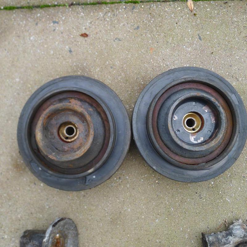

Actually I think I know exactly what you mean. Feels like your driving on ice? I changed the bushes, shocks etc and it still felt the same. I thought it was me. I got the garage to change these upper mounts and the problem went away, brb got to find some photos for you.
If you look at the state of these its no wonder it felt like I was driving on ice.
