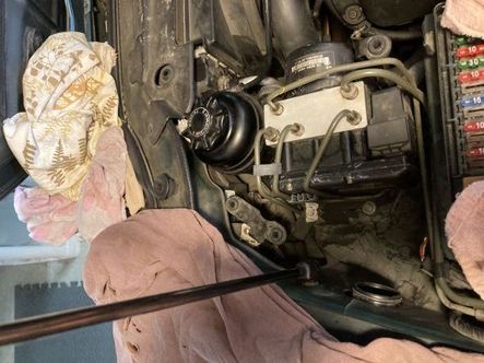

Thank You! I'm just trying to avoid any issues BEFORE I reinstall the module.
NOW.....you described testing the module without actually installing it. I think you said it could be hooked to the two connectors, and you put the unit near the fender. That puzzled me because the harness with the big multi-pin connector is held down very firmly and can't be extended. The two pin connector for the pump is only about 4" long and can't reach anywhere. If I could get a new wire and head I'd extend it about 4 more inches so it wouldn't be so hard to get in and out, but for now it's only long enough to barely reach the module after it is installed. Maybe you have a way that works.
The last thing is the brake lines. Mine are bent/formed really close to the module and the pump. If I can get the connections together, do I have to have the brake lines screwed down tight? They are definitely in the way of the power and CB connectors. I would only hook the module up and turn the key on to see if all the lights went out. I don't think I would need to start the engine....right?
I hope I made sense. Not the best pic, but you can see how tightly this all fits.
The sedans are easy to fit the module next to the fitted one and connect it electrically.
You will likely need to unbolt the unit to lift it slightly on the X100? (been a while since I worked on one for this test)
I just lift them to replace the faulty one and reinstall. I never had one fail after I repaired it for a C1095.
I have a few with C1155 HARD FAULT that would not clear on any car that was proven to NOT have a problem with a speed sensor or circuit wiring.
I just toss them and move on.
