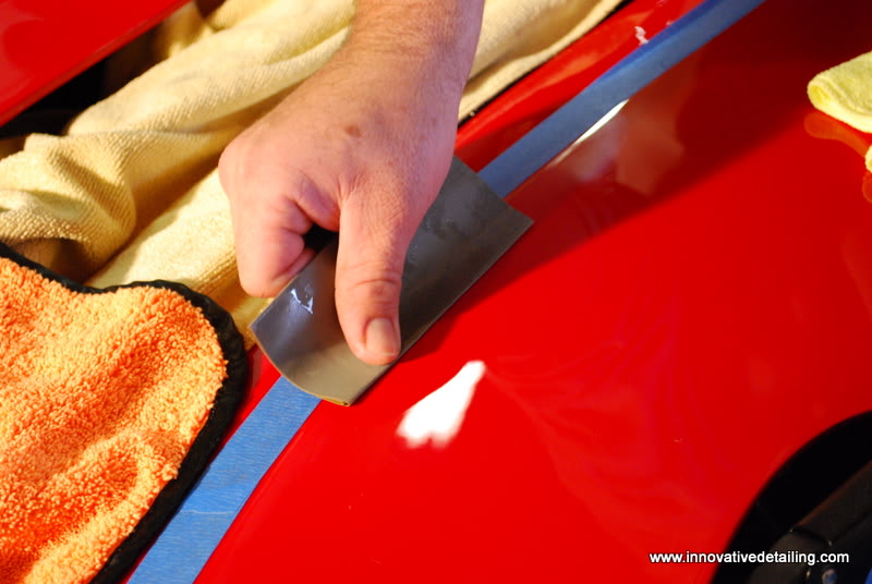

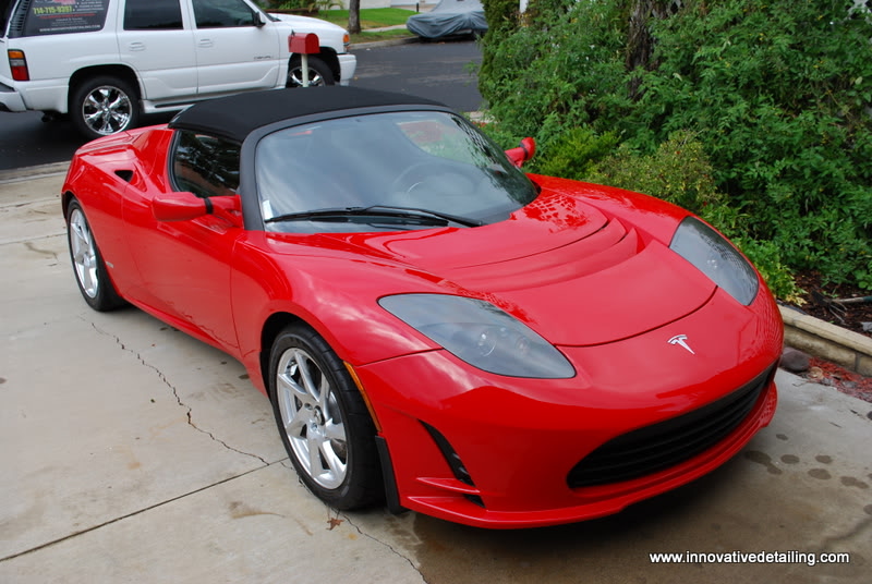

Here is an example of a 2011 Tesla that I recently was hired to correct for Tesla Motors. take a look at these photos, are these similar scratches to what you are describing?

These photos show scratches that the dealer described as "Something dragged" across the hood of the vehicle.
If they are anything like the photos above, yes flat (spot) sand with wet 2000 and then polish up with a wool pad and M105
