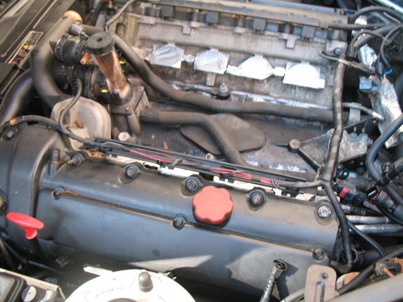

To give an idea of the condition of items i am trying to restore, i have included some pictures below.

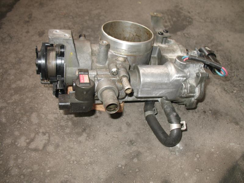

For the removable parts like the throttle body, i'll see how far the wire brushes and some polish get me.

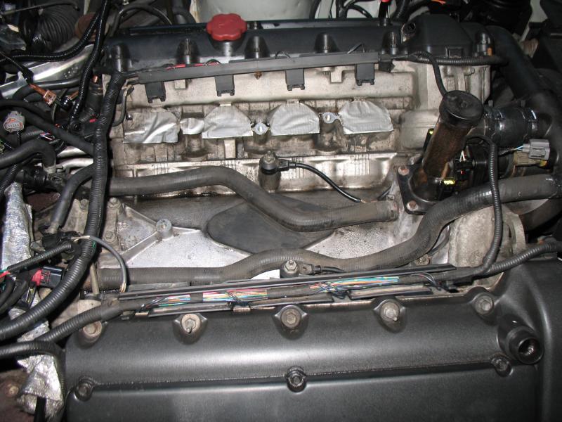

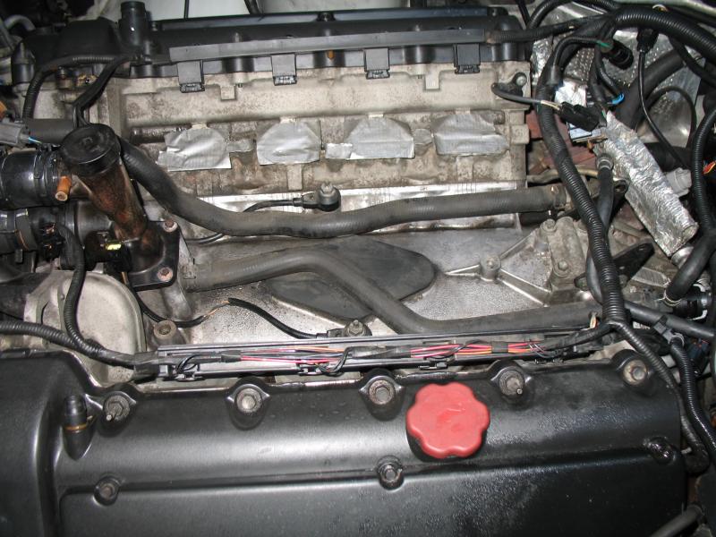

I've put some piccies in so you can see what the block was like, and a couple to show the improvement made with some degreaser and soapy water. But the sides of the heads still look pretty grotty, so i'm hoping the spray on stuff will sort that out.
The block looks like it has a different finish to the heads, though i thought they were both alloy.
I'll probably have to settle for just having them look "clean", as opposed to "as new".
