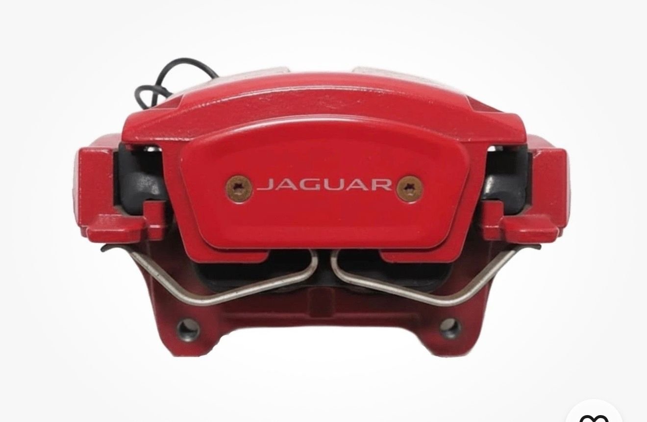

Here are what the factory red painted calipers look like. As you can see, the part that has “Jaguar” on it is just a cover to cover the open area behind it. I believe the only difference between the painted ones and the non painted ones (on the 26 model) is that plate..
you can find them on eBay (full caliper) and you can see the plate is screwed onto the caliper

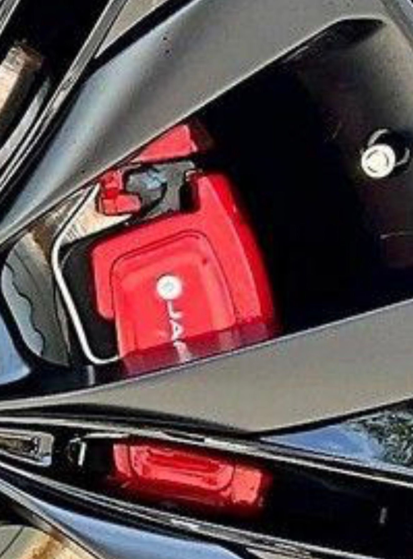

This is from eBay

That little cover snaps into the holes in the caliper, if your caliper has them, it should fit. I will check my work car tomorrow out of curiosity, as I though they all had them. Mine is R-dynamic but only a P250, not the real engine.

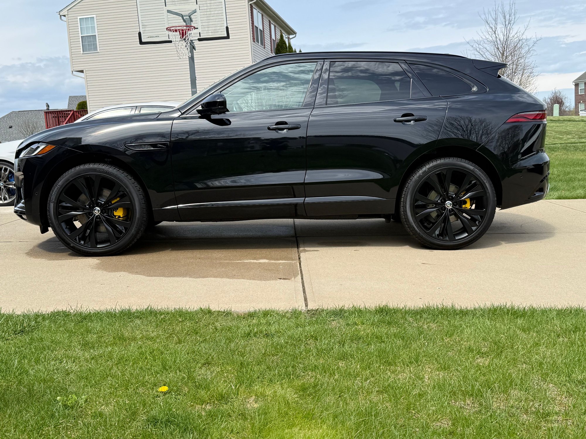

pics after the caliper job.. ugh.. not fun but I think it looks pretty good.
I used G2
