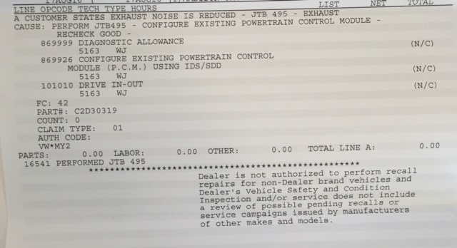

The JTB495 update needs to be applied: https://www.jaguarforums.com/forum/f...7/#post1663695

OP and others, did you guys get anywhere with the JTB update?
This is probably far fetched, but my 2017 R seems relatively quiet compared to my previous 2016 R--I question what software I have from the factory--one would think the latest and greatest. My build was 11/16. Perhaps I'll eventually end up with more crackles and pops as my exhaust breaks-in. I only have approx 600 miles. But to me, I think my '17 is much quieter.
Originally Posted by ek993
All I had to do was quote the JTB number and the dealer applied a newer version of code to the one I was on.
When was the last time your car received a software update? K309 was applied around March 2016 and a newer version of code was applied around August 2016 when I took it back in for the JTB. So the newer code was released sometime around Summer 2016 I believe. If your car hasn't been updated since then it's probably a fair assumption you don't have the latest and greatest.
Show them this screenshot, ask them to look up and read the TSB and confirm that they have performed the action prescribed in it.
You can also ask them to provide you with the current version of software running - they have no valid reason to refuse to give you this information.
Beyond that if they still push back escalate to JNA.

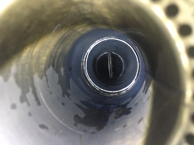

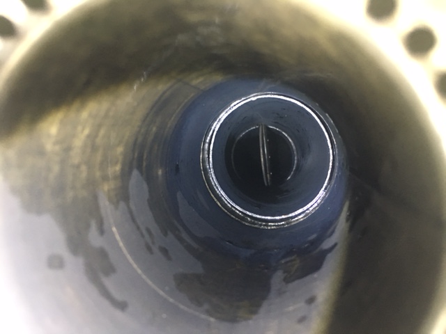

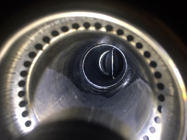

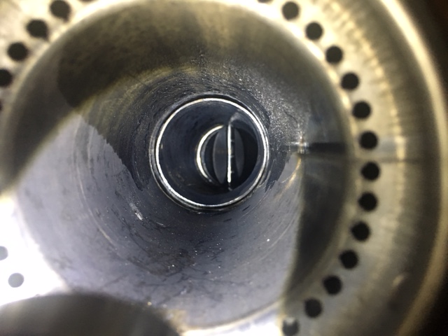

Ritzy, I know this Thread is titled in part--"not valve problem," but have you looked at your exhaust valves? Do both your driver and passenger side valves fully open? I'm having an issue with my passenger side not opening completely--not parallel to the exhaust pipe. For reference, this is a cold startup with dynamic mode turned on--2 pics each of each side.

good idea. I'll have to confirm myself. The dealer says they have tested the vacuum operation of the valves and confirmed working as normal. I also notice when this issue arrises, it sounds like the valves are open as the exhaust note is much throatier. It's just missing the snap crackle pop bit, but by no means is it in quiet mode.
