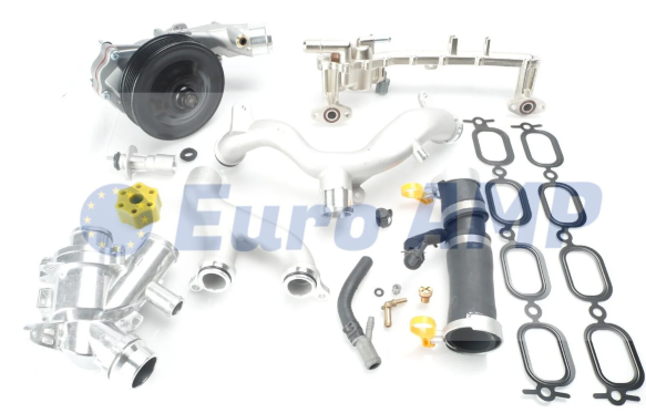

  • Cooling System Upgrade
    • SR Silicone F-Type AWD Radiator Hoses Double Pack C2P24293 T2R7744 × 1
    • Coolant Overflow Reservoir Tank Compatible with Jaguar F-Type 2014-2021 [3.0L 5.0L], XK 2007-2009 [4.2L], XK XKR 2010-2015 [5.0L], XKR-S 2012-2015 [5.0L], Expansion Bottle with Cap Replace# C2P25607
    • VAP: Pierburg CWA150 Water Pump - 2015-on Jaguar/Land Rover AJ133/AJ126 3.0 5.0 Supercharged Engines
    • Euro AMP: 15-25 Jaguar Land Rover Cooling System Upgrade Kit V2 5.0 V8 Supercharged Engine × 1

Still original coolant pipes and water pump? Not positive but seems like many see seeping around 35k. I am not sure that is accurate-I am just under 30k on my 2016. I figured soon I was going to get updated coolant pipes and swap the water pump to be safe.

Plugs, accessory belt, check injectors, s/c oil, clean valves, change coolant lines to aluminum. Or at least upgraded plastic version.
might as well get it all done since you`re in there.

That's an already impressive list of stuff in your garage, including those brake upgrades - should make your car drive noticeably better. Only thing I can think of is some folks have had issues in the past with QC on those aftermarket metal pipes, some folks have had them leak after some time (o-ring issues, rear metal pipes issues, and sometimes the metal coolant pump outlet). Jaguar makes OEM alloy upper and lower front pipes now. You'll probably be fine though. Great on the upgraded VAP tensioner as well. Only other thing I can think of is maybe a service on the transmission, sc oil change (couplers i think are in the kit), and maybe be prepared to replace the valve cover bolts under the SC if they are in bad shape (yours should have the relocated vents so might be fine). Also did you consider VAP cats/downpipe?
