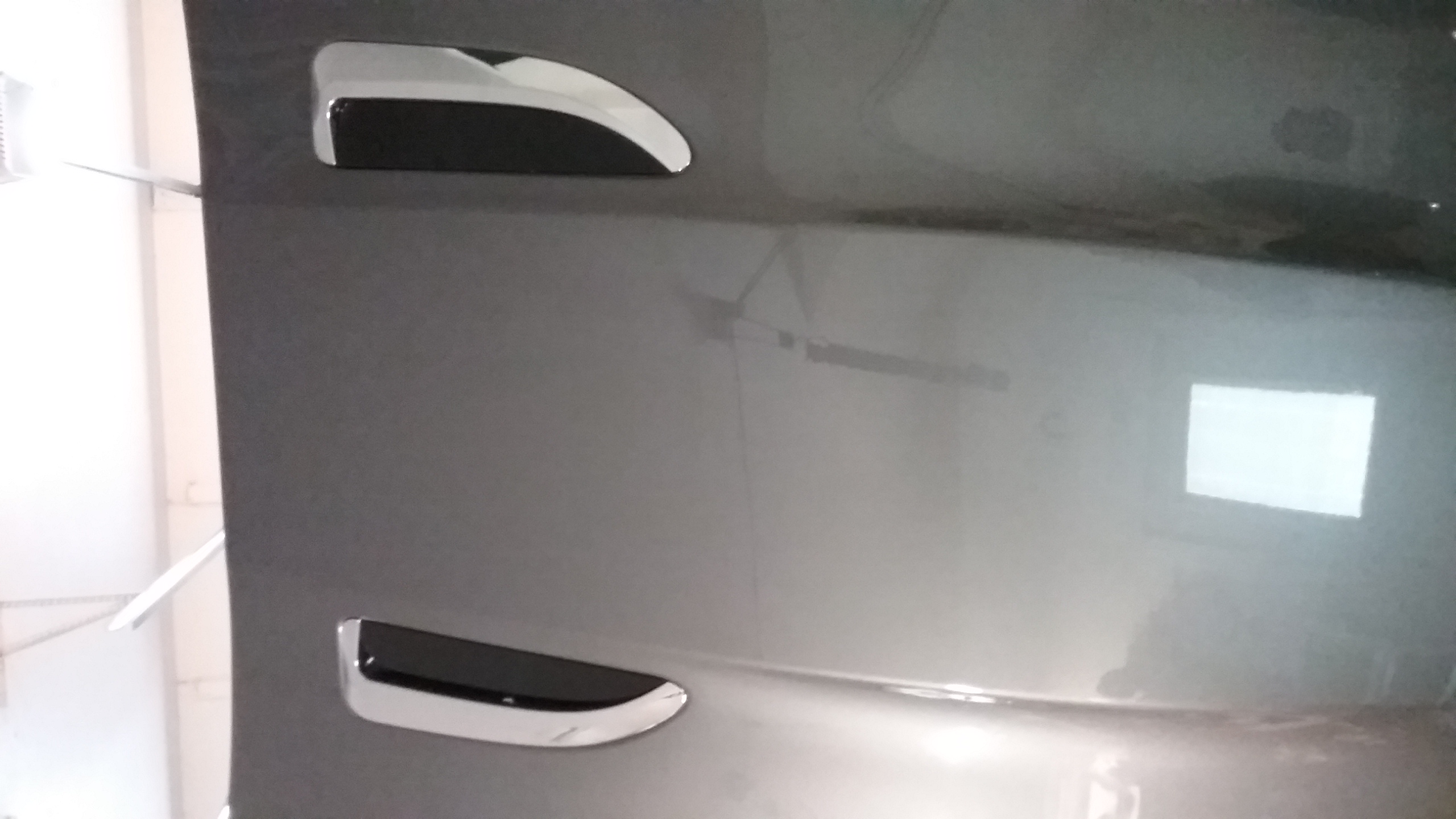

If you want to see what they look like on a dark color here's a good example. They really pop in person - the pictures don't do justice so I posted a few. My PPF installer just popped them in. I really think they complement the chrome side louvers and just add that touch of differentiation. The sales guys at my Jag dealership flipped over them too - Bling!

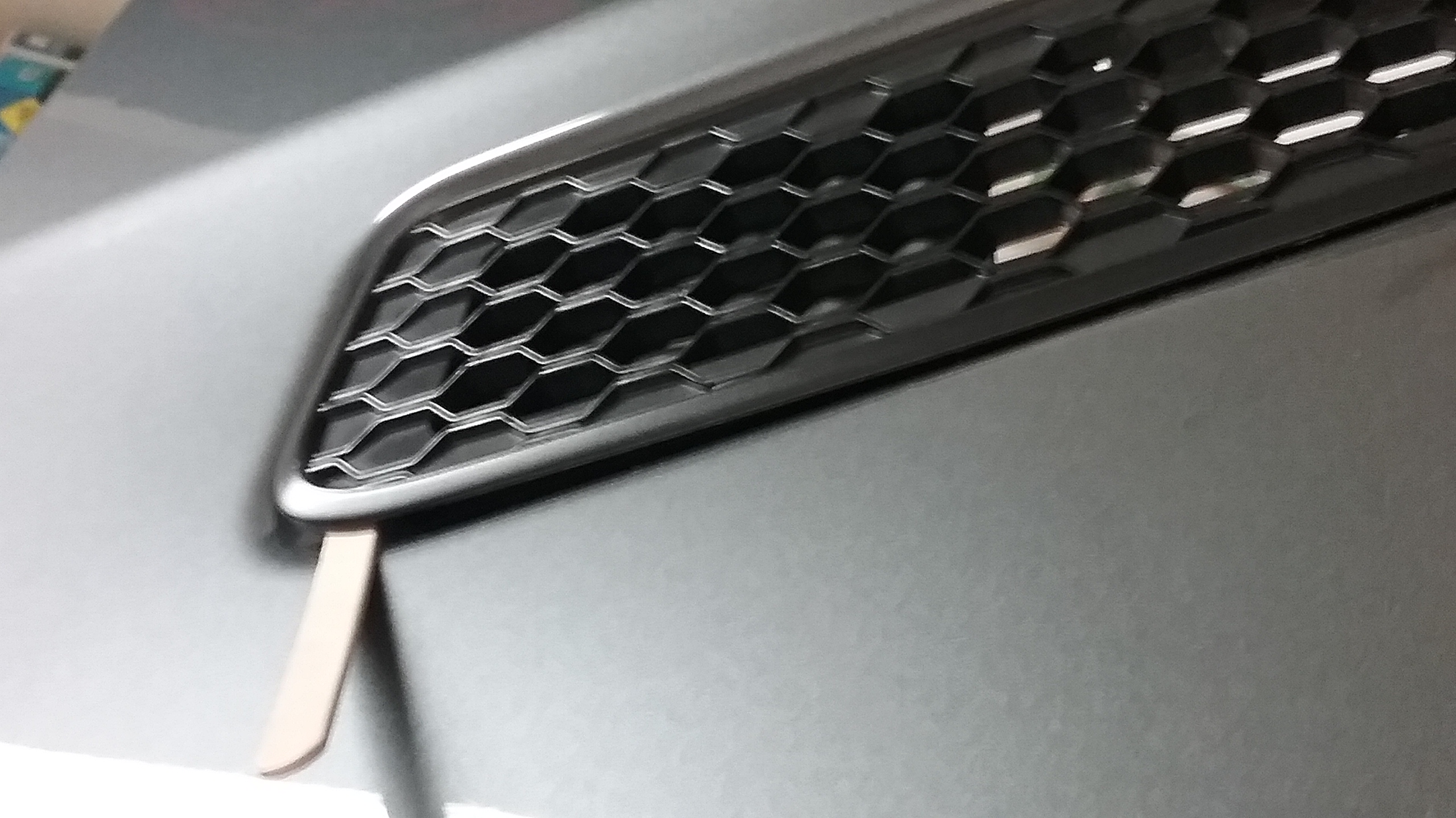

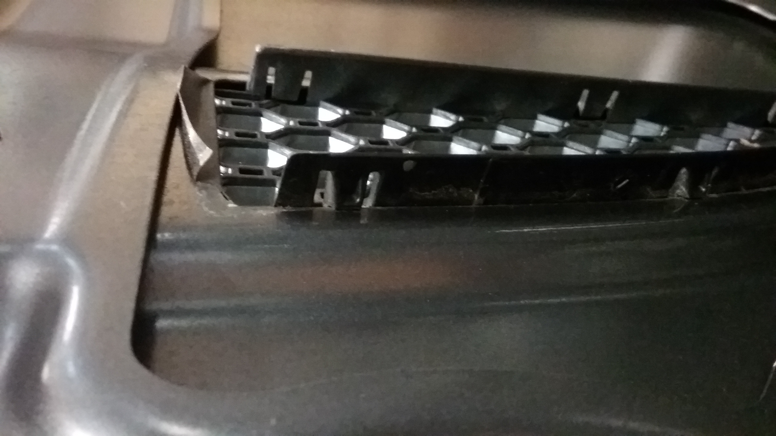

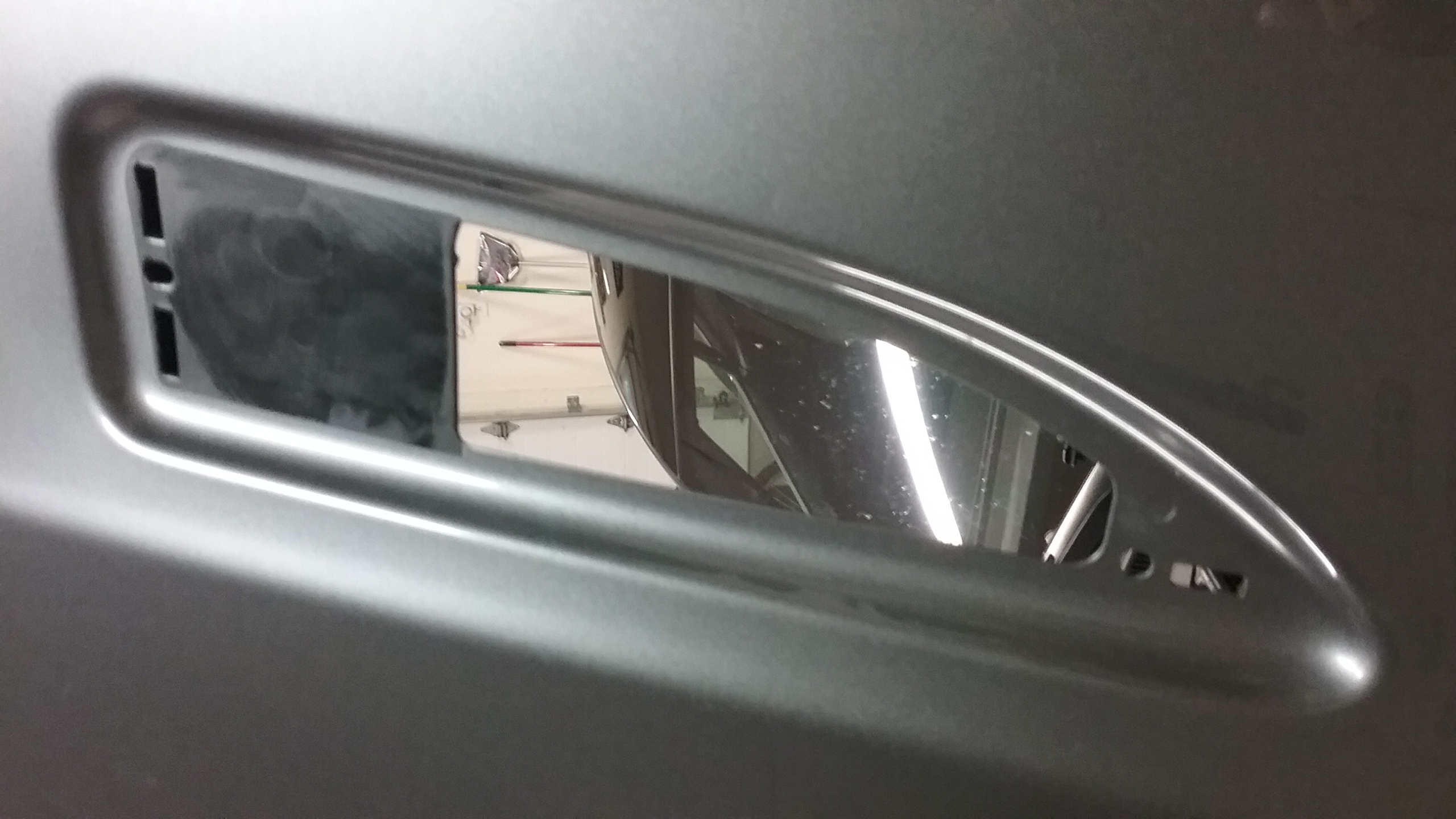

after their part number issue, JLR parts place sent two right hand sides, but has since MORE than rectified problem. I used all the wisdom from this forum to replace the stock vents on the 2017.

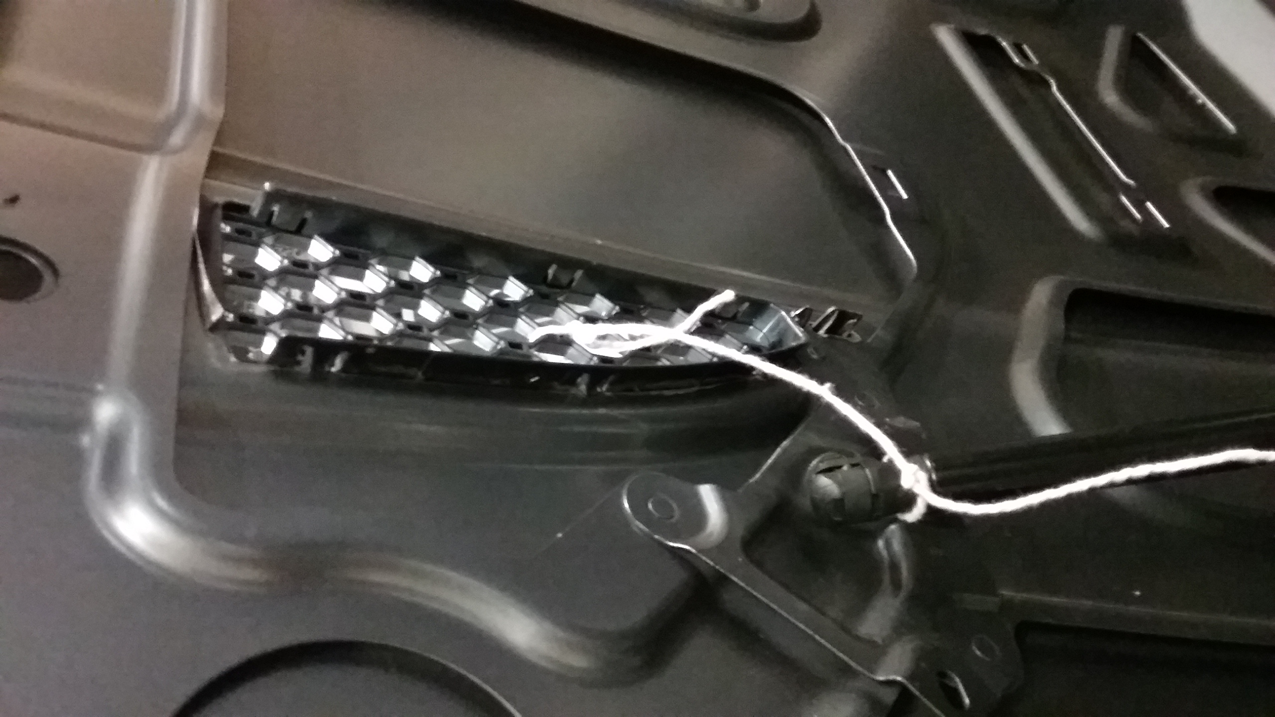

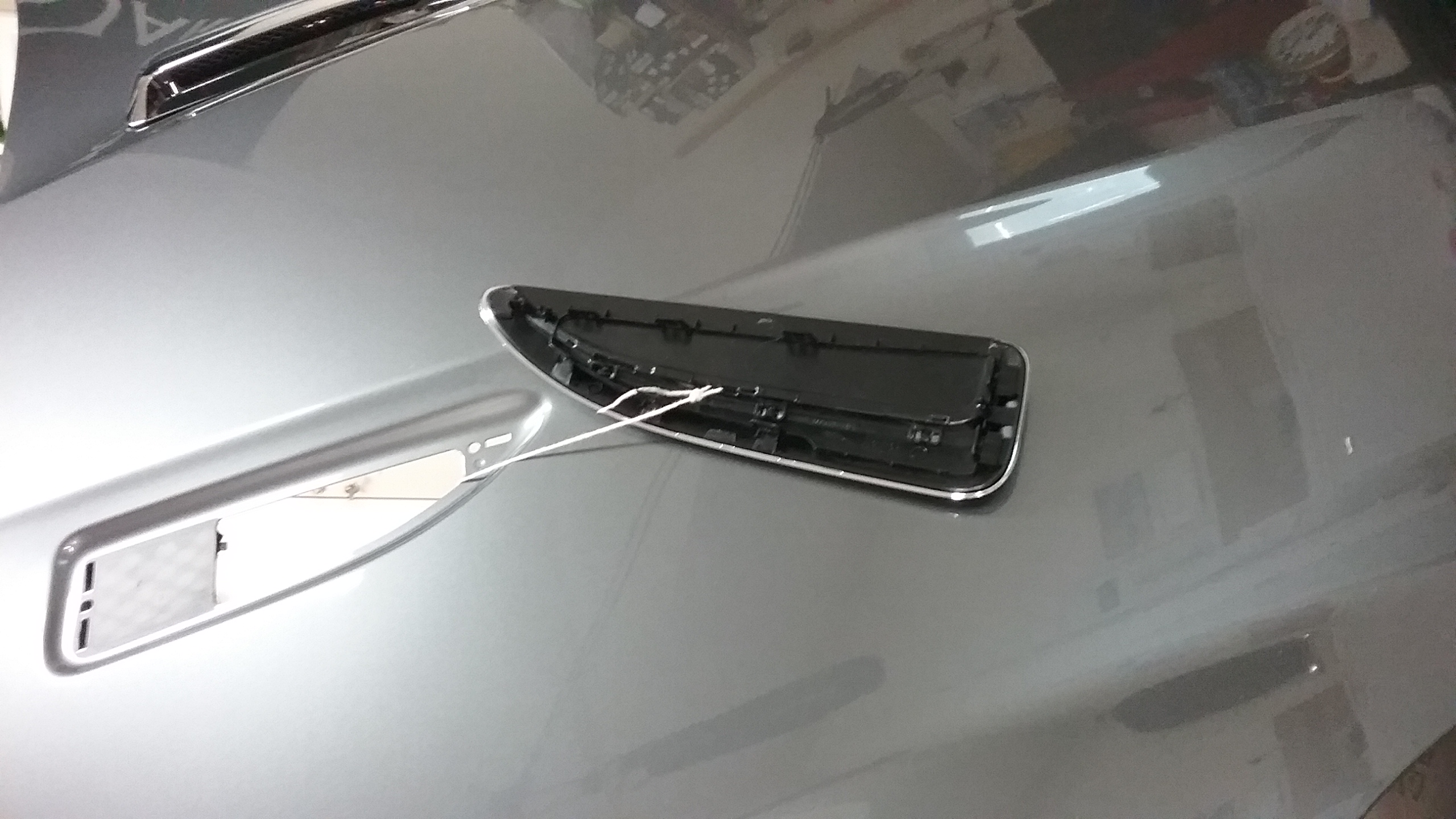

First piece of good advice: Tie the old vents to the hood/bonnet struts to keep them from falling off/breaking/snapping off a clip. I think I will probably hang on to these, they are/were OE. I also tied the new ones to the struts, for the same reason.
Second piece. wrap flat blade screwdriver with electrical tape, so as not to scratch paint.
I used a popsicle stick to keep the OE louver from snapping back once I had flipped the clip from underneath.
I added the Kilroy link because that last photo reminded me of him. LOL
Lizzardo's link/post to the Jaguar instructions, while wordless, provided enough visuals to get the job done. I can't find that page right now, but will post it, unless someone gets there faster.

I didn't do any prying from the outside. I work the clips one at a time from underneath, but I did also use the electrical tape trick on a screwdriver.
I also used finger pressure to keep the clips that were released from clicking back into place. Patience is key.
