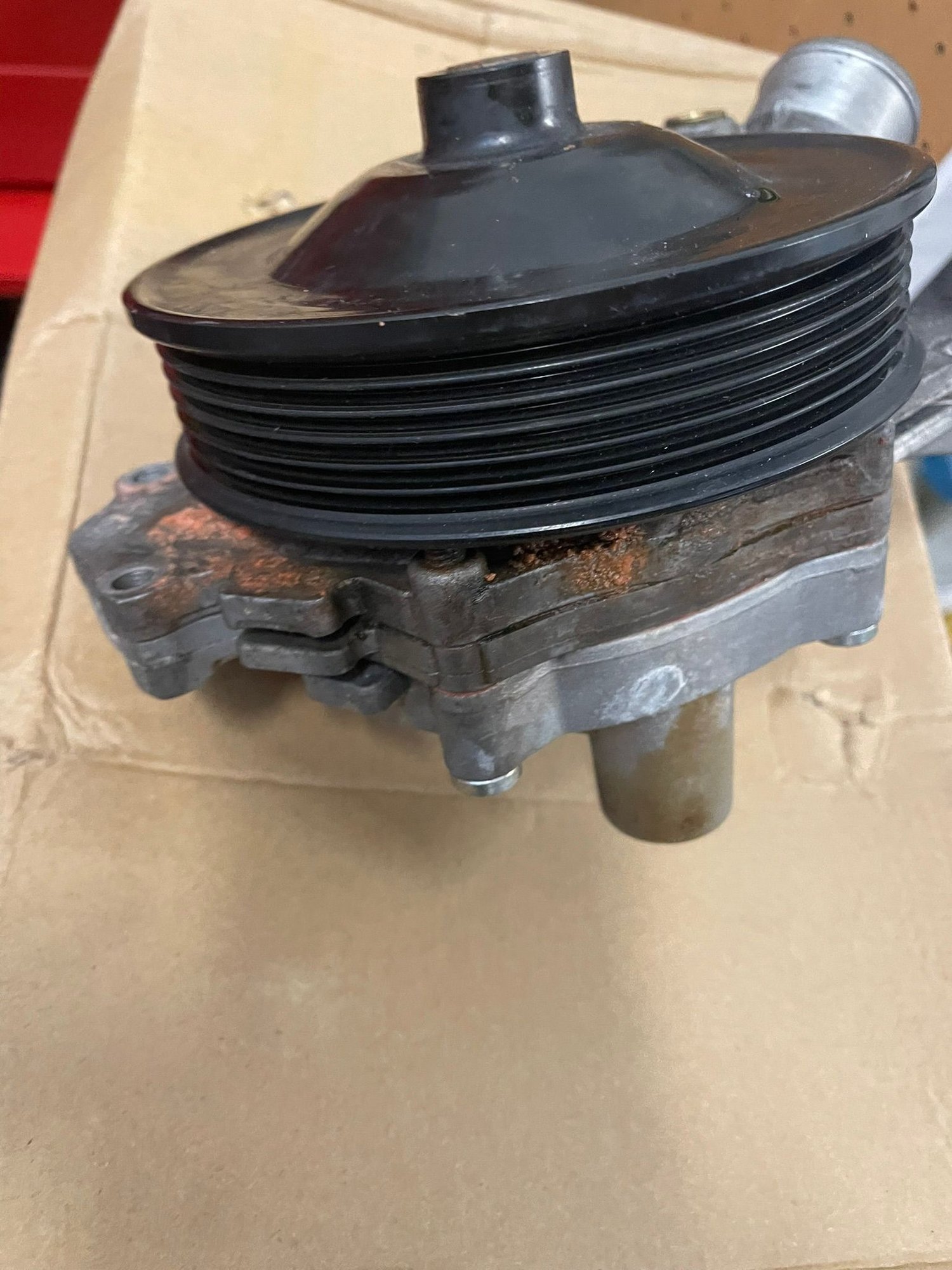

Have your 'guy' check the water pump. They were known to leak.
See the coolant stains?
