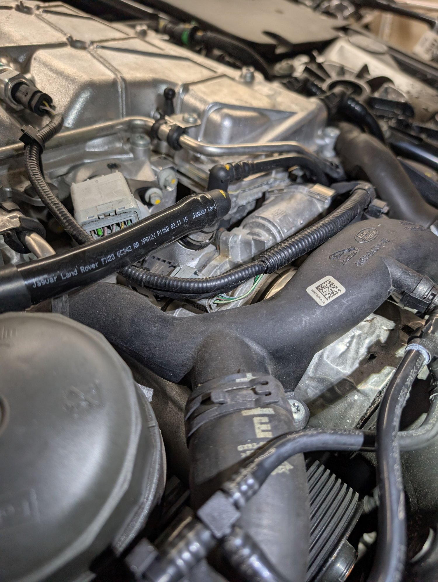

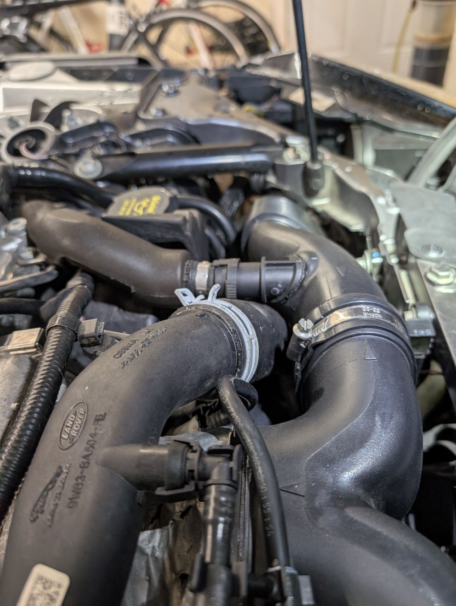

2016 S AWD. Not sure if I'm even looking at the right thing, but wondering if my coolant y pipe has been replaced/upgraded?

Yes. You have the seamless plastic pipes. The originals were replaced.

Oh wow! That's a really nice surprise! I had this car 3 months now and I'm super happy with it! The coolant y pipe was on my radar, but hopefully I can stop worrying about it for a while ( car has 49k miles ). Thanks for confirming! I know there's an even better option, the aluminum pipes, but this seems like a good start!

Keep an eye out for leaks/low coolant in the reservoir. There are several other items that can go bad.

The above is correct, 2 bolts per side on the rear crossover for the v8. Also, while you have the new style front crossover, this is not your y-pipe, which is below the left side of the crossover and may or may not have been replaced, even if so is undoubtedly still plastic and still prone to brittleness issues.

I was told the 3rd gen (2nd gen plastic) crossover pipe supposedly does not work with a Y pipe not matching it’s generation.
