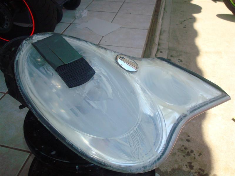

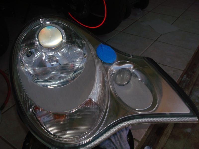

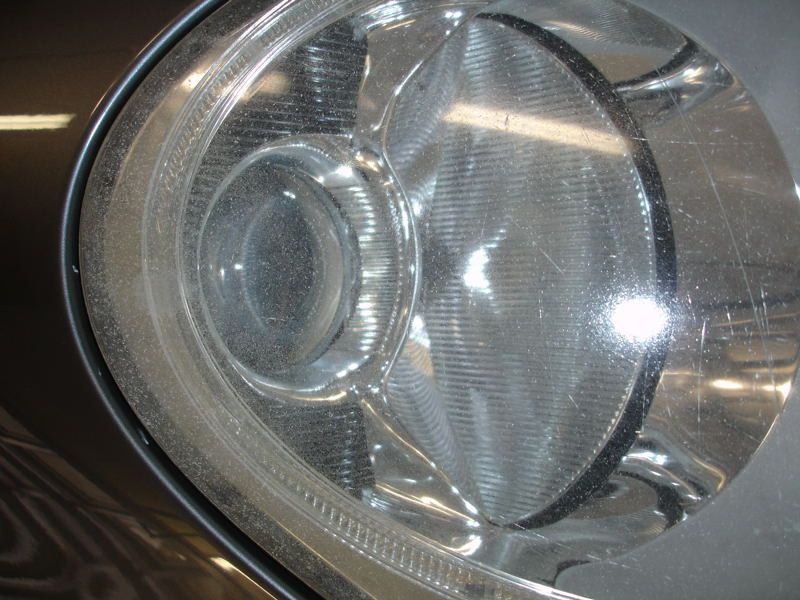

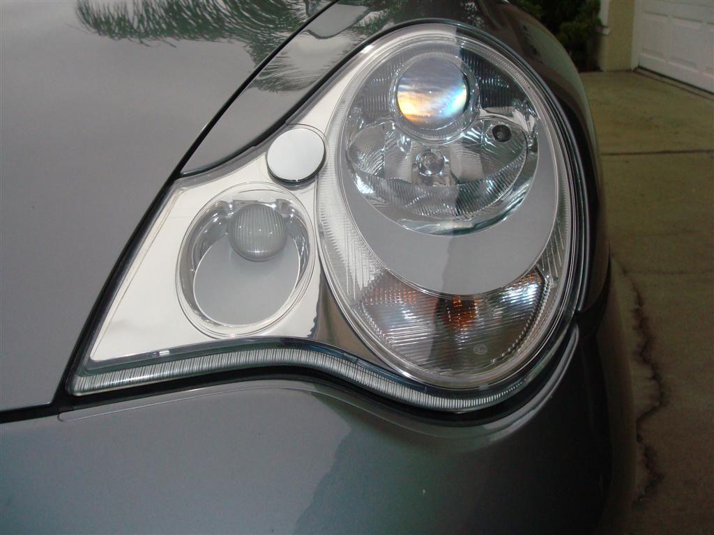

If you do not have cracks inside the lens, then it is an easy restoration process. Wet sand the headlight, starting with 1500 grit sandpaper. Keep going up with finer grit (2K, 3K, 4K). Then polish with Meguiar's PlastX.
You will need to apply a clear coat with UV protection if you want it to last. I did this years ago to one of my cars.
I did install some XPEL headlight film to protect it further... here is a photo after the work done. Again, not difficult. Take your time. Mask the surrounding areas if you do not remove the headlight.

The headlights photos are from my 2002 Twin Turbo. Now gone.
