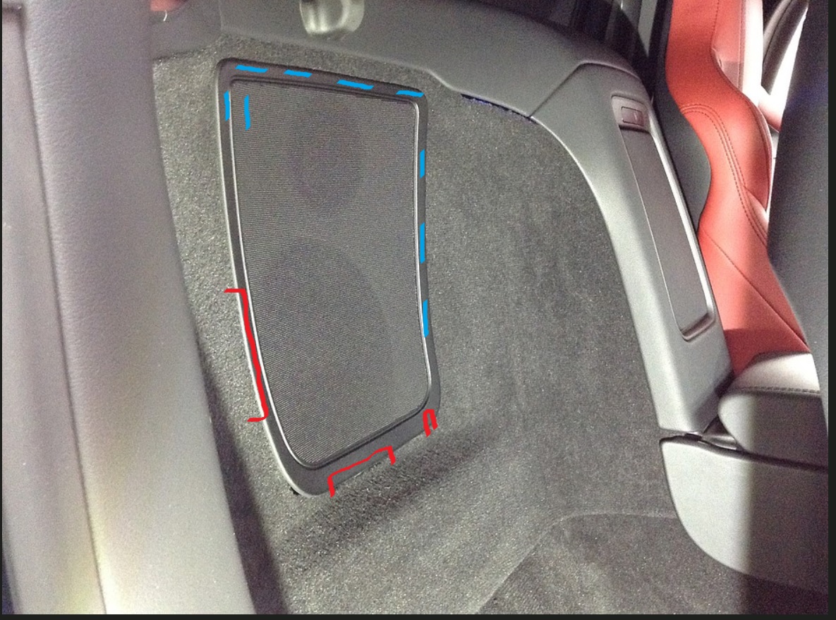

hmmm i'm confused here - the speaker grilles are set in the carpet, can't you just pull the grilles off to get access
my grille is rattling under heavy base too
this is how the speaker grille attaches - i put this pic together using the rattle fix pdf
the red markers are tabs which slide in behind the carpet, the blue markers are push clips, so looks like you use a trim tool and start at the inside top edge to pop the push clips free then walk it out up and towards centre console
Attached Thumbnails How Do I Get To My Subwoofer?-untitled.jpg   How Do I Get To My Subwoofer?-untitled2.jpg

@domino_z thanks for the diagram. I do not believe this opens up enough space to access wires, but good to know they come off. I spent a little time trying to remove it and only achieved anger and sore fingers so far, so I can not yet say for certain if this will get me to the wiring. Disassembling things on this car is....interesting.... I still believe I may have to remove the whole panel to access anything there, but I'll continue to curse at this part and try to make progress.
