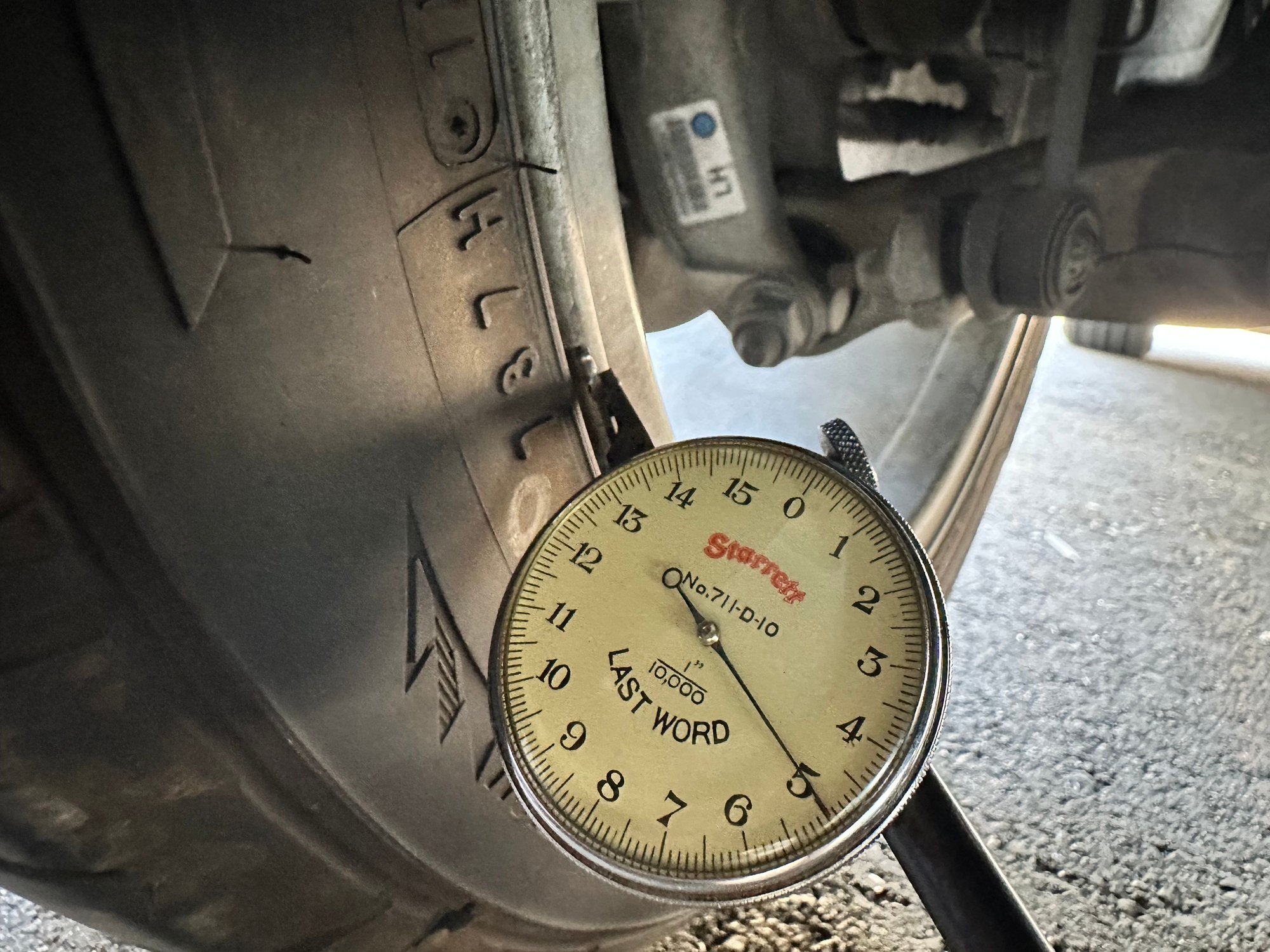

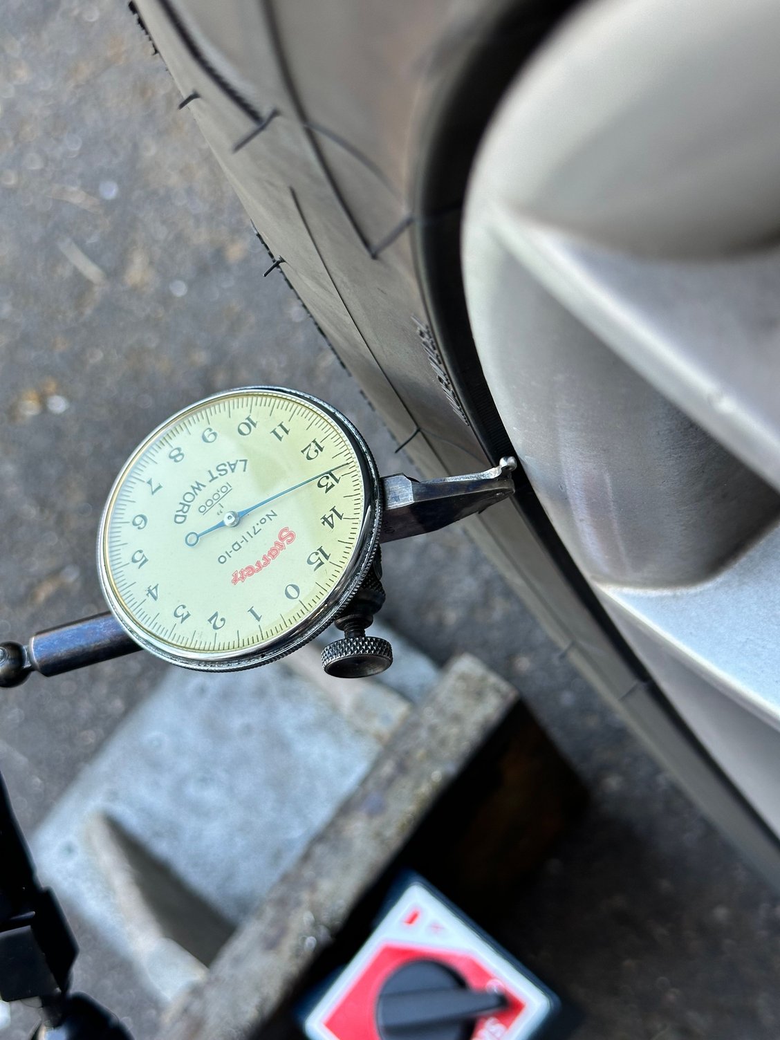

Did some tests, set up a dial indicator on a few spots as shown. The drivers side rear, has about 2mm of wobble- unclear if that’s axial or radial. All the other ones have about .5mm- I did this mounted on the car, and spinning them by hand, so I’m going to say that the .5mm is a margin of error.
I also lifted the car back up in the rear, and put the car in gear (following safe practices of course) and listened with a stethoscope to the hubs and the diff, no odd sounds that I could hear, so I’m thinking it’s tire/wheel related.
Might go see if the local tire shop has a tire machine that can measure runout and dial it in a bit better.
