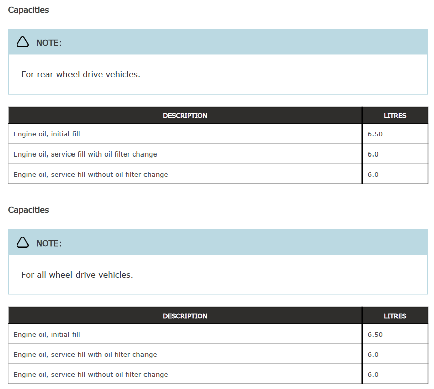

"My" service manuals says differently...

Then your service manual is dead wrong!
It has been well established for many years that the correct oil fill amounts (wet fill not new/dry fill) are 6.5 litres for an AWD and 7.25 litres for a RWD.

Originally Posted by OzXFR
Yep.
J444G has a 2017 V6S so I was responding to him in particular.
Dunno what the 2.0 four potter oil capacity is but I vaguely recall 6.0 litres and that may explain the posted service/owner manual extract, coz as we know the owner manual at least almost always includes every possible variant and option whether the car has it or not.
So my guess is that J4446 posted up the 2.0 oil fill specs out of his owner manual but that manual also has the oil specs for the V6/V8.
It is from the 6500 pages repair manual. It might be wrong of course.

That sure ain't what my copy of the repair manual says!
Mine says:
Capacities
DESCRIPTION LITRES
Engine oil, initial fill 8.75
Engine oil, service fill with oil filter change 7.25
Engine oil, service fill without oil filter change 6.75
Something screwy with your copy I reckon!

Thats funny, but considering that when I was searching for the car Jaguar can't often even get the correct color of the car in the VIN database I am not that surprised anymore
