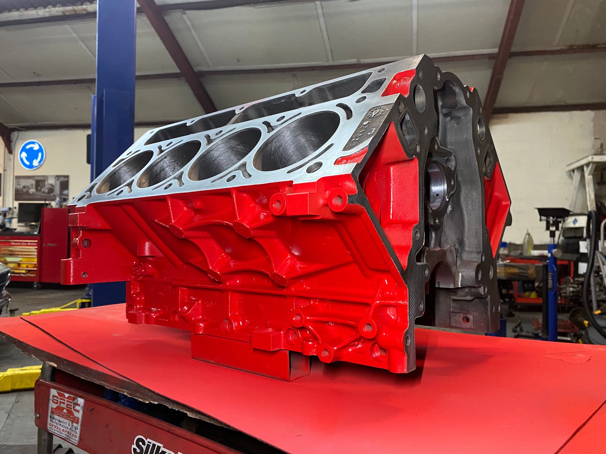

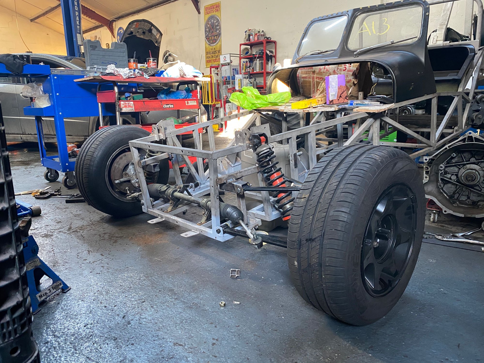

OK so I’m building a kit car from the chassis upwards with an 800bhp 6.0 v8 LS engine. Twin gt45 turbos custom front suspension which I just got rolling today.

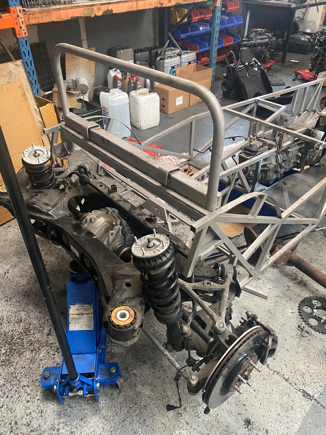

basically I’m using a 2017 F type rear subframe hubs arms the lot. Paid £200 for the lot.
for this application I don’t need or want EPB and the previous owner has removed them anyways and I need a handbrake. Looks like I’m going to have to just trial and error with different Calipers to see what fits.

Most other modernish Jags use the same size rear brakes as the F-Type, just without the EPB integrated into the caliper each side, the F-Type is unique in this regard. Either 326 mm (same as the base F-Type so I suspect that is what you have at the moment) or 376 mm.
I swapped my 326 mm rear brakes for the 376 mm ones and it was simple plug and play, and although they use slightly different calipers and caliper brackets both bolt right up to the same hubs.
Point is, I suspect the rear brakes with single motor EPB driving two cables from the XF, XJ, XK etc should bolt right on up, and that way you can get rid of the integrated EPB motors in each caliper.
But of course that still doesn't solve the problem of getting rid of the EPB itself and replacing it with a manual hand brake, but I suspect with a bit of R&D you can figure out a way to replace the central EPB motor with a manual cable set-up.
Edit - AFAIK the F-Type rear hubs are the same as the XF and XK rear hubs which in turn are the same as the S-Type which in turn used the same basic chassis and suspension as the 98 - 2005 Lincoln LS and Ford Thunderbird. So if (and that's a big if!) those two Fords used a mechanical hand brake and not an EPB the parts from one of them could bolt right up to the F-Type hubs. It shouldn't be hard to get the parts for cheap from a wrecker so worth a try!
Just to note that the 2016 XJ did start sharing the rear calipers with the EPB motor mounted directly to them, so I suspect other recent/current models may have also gone down the same route as they do like to reuse parts.
They will fit, and as you mention the S-Type (at least the mid-release facelift) and the the X350 also have compatible hubs which the brakes will mount directly onto. I replaced the factory brakes on my 2004 XJ6 3.0 with those from an 2011 XJ, partly because the factory brakes were not the best but also because the later consumables are more readily available and will be for longer. The calipers were straight swaps although the hoses needed swapping too as the mounting position changed. The only modification was to reduce the length of the front caliper bracket bolts by 5mm so they did not contact the discs.
