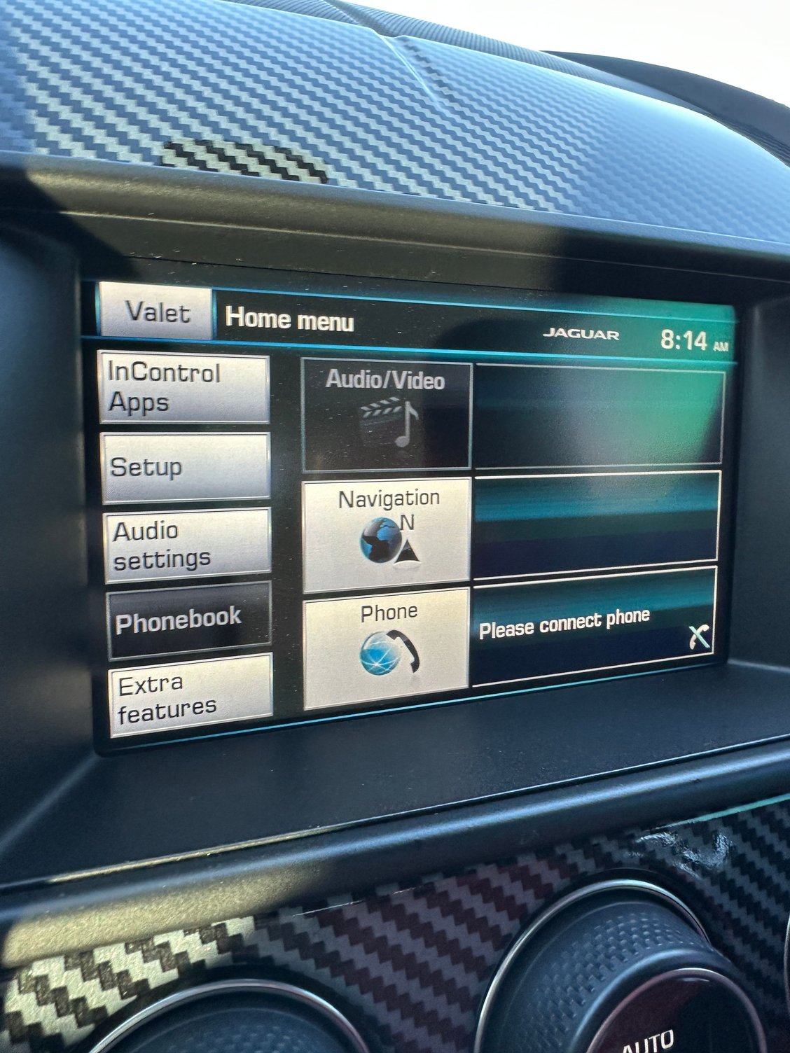

Tried search, so sorry in advance if covered. I've had the Audio/Video button on the main screen go gray on and off for some time now. An internet search came with lots of folks experiencing it, but I never did see anyone get any resolution. Well I thought I'd try removing the carplay unit, which had been giving me fits of its own, and even in stock form, the AV worked one day, but alas, not the next. So finally my question: Has anyone ever gotten an "entertainment system ONLY" update, that didn't involve the whole system? (i.e. kept your burps and burbles.....) Thanks!

What year is your car (Bosch vs Harman vs 2019+)? Can you run an OBD2 scan for error codes relating to the AV system? A picture of what you are referring to may help. How was your Carplay unit wired?

Thanks. Its a '15 with the bosch system. I scan at an indy with a much better tool that I have, showed no errors. The car play was one of the IDcore variety, but has been completely removed. See pic. The AV button is grayed out, and most of the head unit does nothing. Selecting Nav or phone, (while still white and selectable) does nothing. Thanks!

Well, it’s in Valet mode. I don’t what’s limited in that mode, but I’d figure out how to turn off Valet mode first!

thanks, but actually, that button is always there, in order for you to put it INTO valet mode. Not in valet mode currently.... Thanks!

Interesting, mine has never shown that.

Interesting back at ya.... I had to chatgpt it, but apparently it didn't come standard until 2017. On your '14 and my '15, it was only on certain "packages...." who knew!

The other possibility is I’m a moron. Just drove my car, and yup, mine’s said Valet for the past 12 years. 🙄
