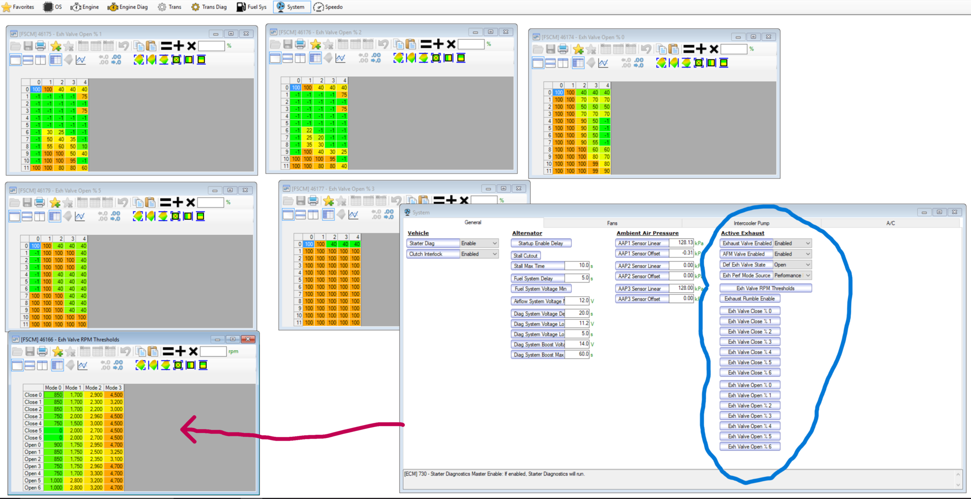

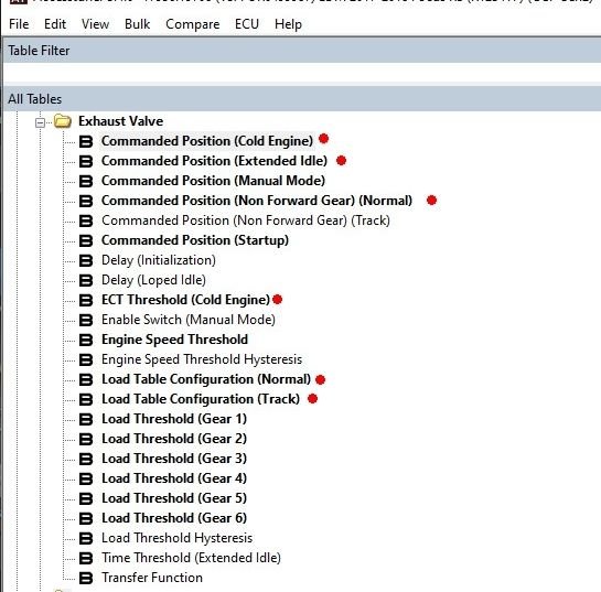

Keep in mind, the dealer network has no access (or detail knowledge) as to the content of a SW flash or SW rev roll. They only know what the factory describes the flash is for. The factory can say - a mandatory flash of all the following cars upgrades the NAV (for instance), but also includes some data mods to another function that is conveniently missed in the field description.
After a certain year with most performance cars that use exhaust flaps, the technology moved from a simple vacuum system to a much more complex electric (step motor) system. With Jaguar I believe that was MY 2021. So any MY 21 and newer will have this newer system. With it, the ECU controls much more and in a much wider range how the flaps work and when.
I'll give a couple of examples of what the data tables look like. Again, this came using hack SW. A dealer/dealer tech wouldn't have a clue about these details (unless the tech is also a tuner on the side)
This is an example of the hierarchy data tables controlling the movement of the exhaust flaps, In the lower right, this is the SECOND level access. Each of the greyish bubbles is a data table, once clicked on produces the data in the background tables. In the lower left, is the THIRD level table and showing there is the capability to offer three separate MODES where another FOURTH data level blows out data tables that can be manipulated to change options when and under what conditions the flaps are opened and by how much (as a % of open). With the third level table and as an example, My Aston DB11 V12 has 3 modes - GT, S, S+. When I select any of these modes the ECU switches mode tables which changes the selections of valve opens as a %.
There is a page above all of this at the top level of the tune tables. Again, as a last comment, the dealer tech is not going to have a clue what is shown here. They only push the button that downloads this via the factory instructions in a SW flash. If this is in there, they can't validate is, only what the flash description is.
All of this is just exhaust flap controls. It is a completely different section of the tune files (fuel) that changes the pops crackles, etc. The flaps only contribute a lesser amount to noise level control.
