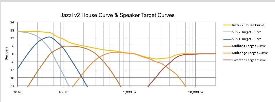

@Evoex I use PowerAmp equalizer for Android on the "Rock" preset - works very well in the convertible with its unusual acoustics, and it works with mp3s/flacs/etc and streaming services. PowerAmp player is a good mp3 player too and has the EQ built in. A lot of settings for music geeks like me.
I have my Audiotec Fischer DSP (which replaced the OEM amp) and speakers tuned to the Jazzi V2 curve as the baseline (similar to the "Rock" preset in PowerAmp).
I wish we could access the OEM Bosch/Harman amp's DSP settings to adjust them and set our own curves, phase, and time alignment. The JLR curve is almost all mid and no bass, which is understandable when you see what the rear OEM woofers look like. As you turn the volume up the bass goes down to mitigate rattles from the rear (rolloff). Done to keep visits to the dealer for rattles to a minimum I think...
