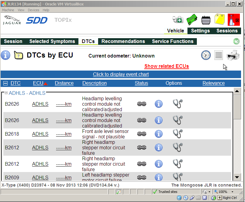

Well, I joined the dark side, and got me one of those clones. I just tested it and it seems to work, see attachment. I installed JLR v134 that came with it both on a virtual machine and on a real laptop. The later hasn't got enough RAM (yet), though, so there it's not really functional.
Apparently I have problems with the lights-leveling system and my audio unit. Haven't noticed anything wrong with any them, but will investigate a bit when I have some time.
The weirdest part is that on the data collection diagram, the ECM unit is displayed as "present, but not responding", i.e. with a round, red X mark. Is that really possible? Car runs fine and a generic OBDII scanner I tried doesn't complain about anything.
P.S.
JLR v134 that I got, comes with a crack that tricks JLR into not wanting any authentication, neither off-, nor online.
From what I see so far, JLR actually seems to be based on a Tomcat application server, so most probably the crack just replaces the authentication servlet or lifts of some servlet filters.
A warning note - before applying cracks, check them with an antivirus software. Mine had some lame virus which I removed before applying the crack.

Old Nov 8, 2013 | 05:30 AM
  #379
JagV8's Avatar
Posts: 27,546
Likes: 4,924
From: Yorkshire, England
Bear in mind those codes could be 10 years old.
Old Nov 8, 2013 | 06:10 AM
  #380
Krasi's Avatar
Joined: Oct 2013
Posts: 29
Likes: 16
From: Bulgaria
Not quite. I wiped everything once I got the JLR connected so, these codes came back.
My main riddle now is about the missing communication with the ECM. Is that the ECU or something else? Because as far as I can tell, the ECU is working. I mean the car starts and runs, and behaves normal.
