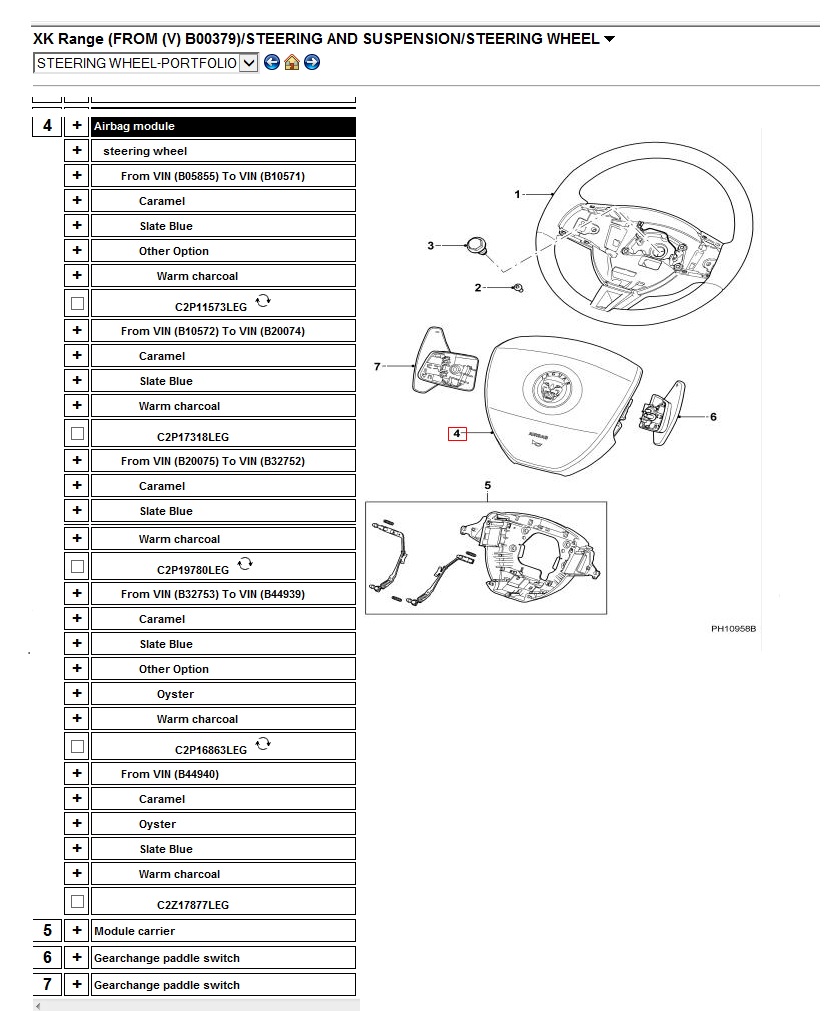

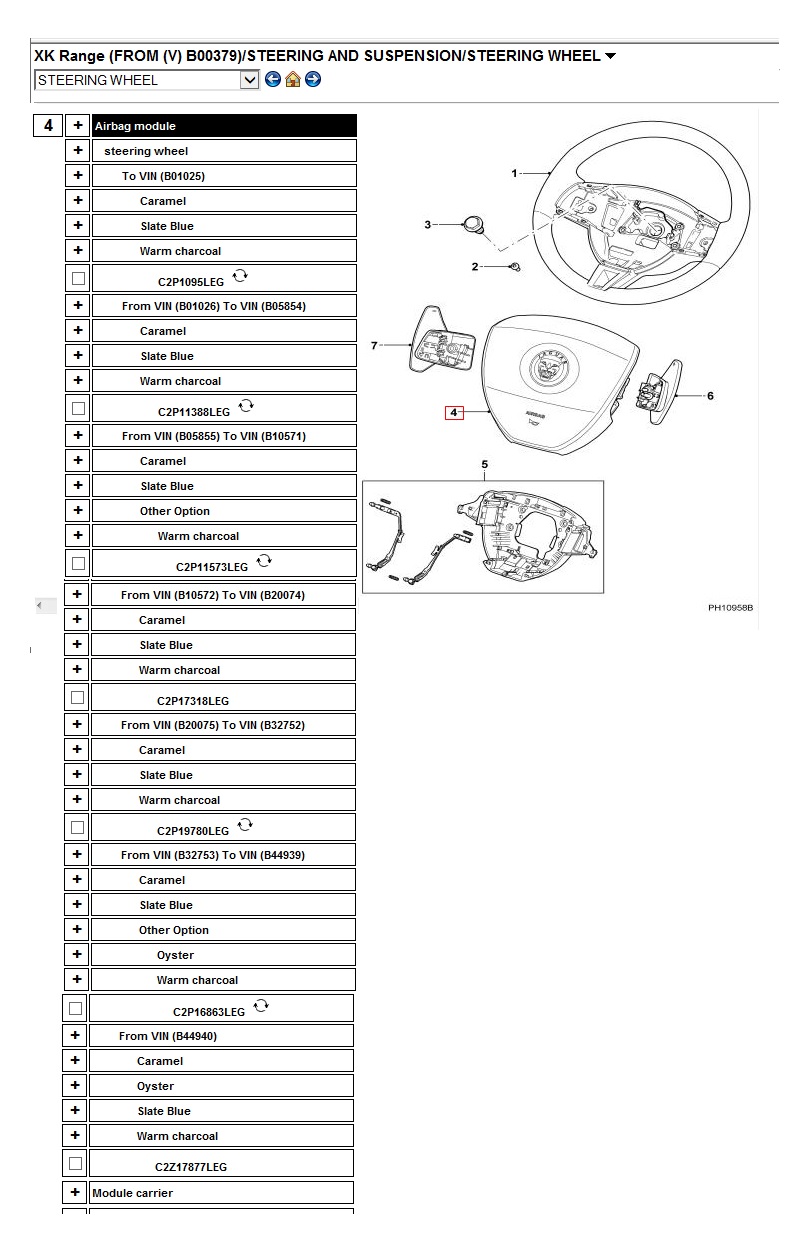

The early Airbags in Charcoal (click on each of the images to enlarge them):
The later including Portfolio:
The XKRS-GT Steering Wheel has no illustration and nothing listed for separately for Airbag:
I therefore assume it's either a complete assembly with Airbag or the Portfolio version fits.
