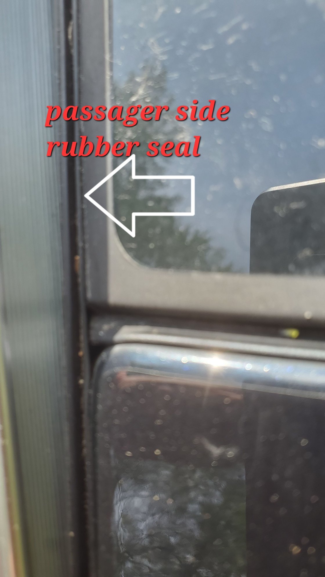

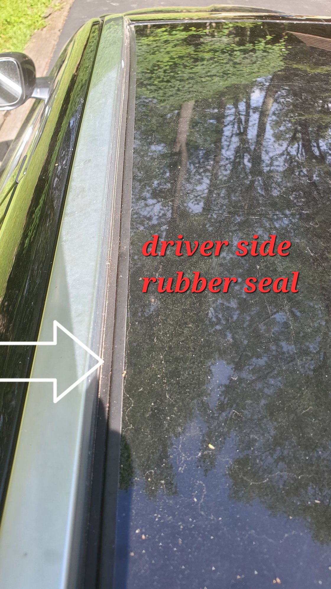

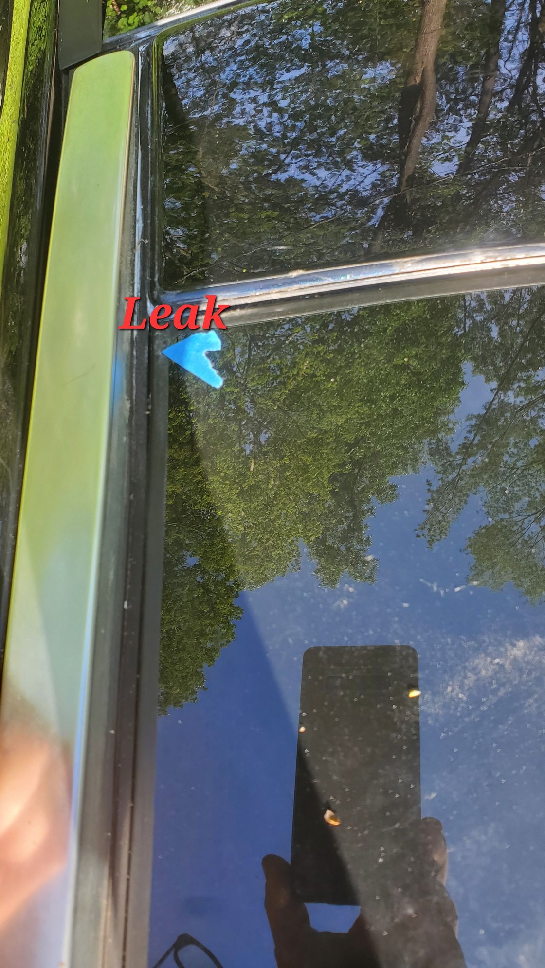

Hope these are clear enough. I tried to show how the passenger side rubber seal is basically a "v" between the glass and body panel whereas the driver side is just laying flat. Hope this makes sense.
I don't see how to remove the roof rail from the exterior so I'm assuming you need to remove the headliner check to see if that may be the issue.

Think the leak photo got cut from the post.
