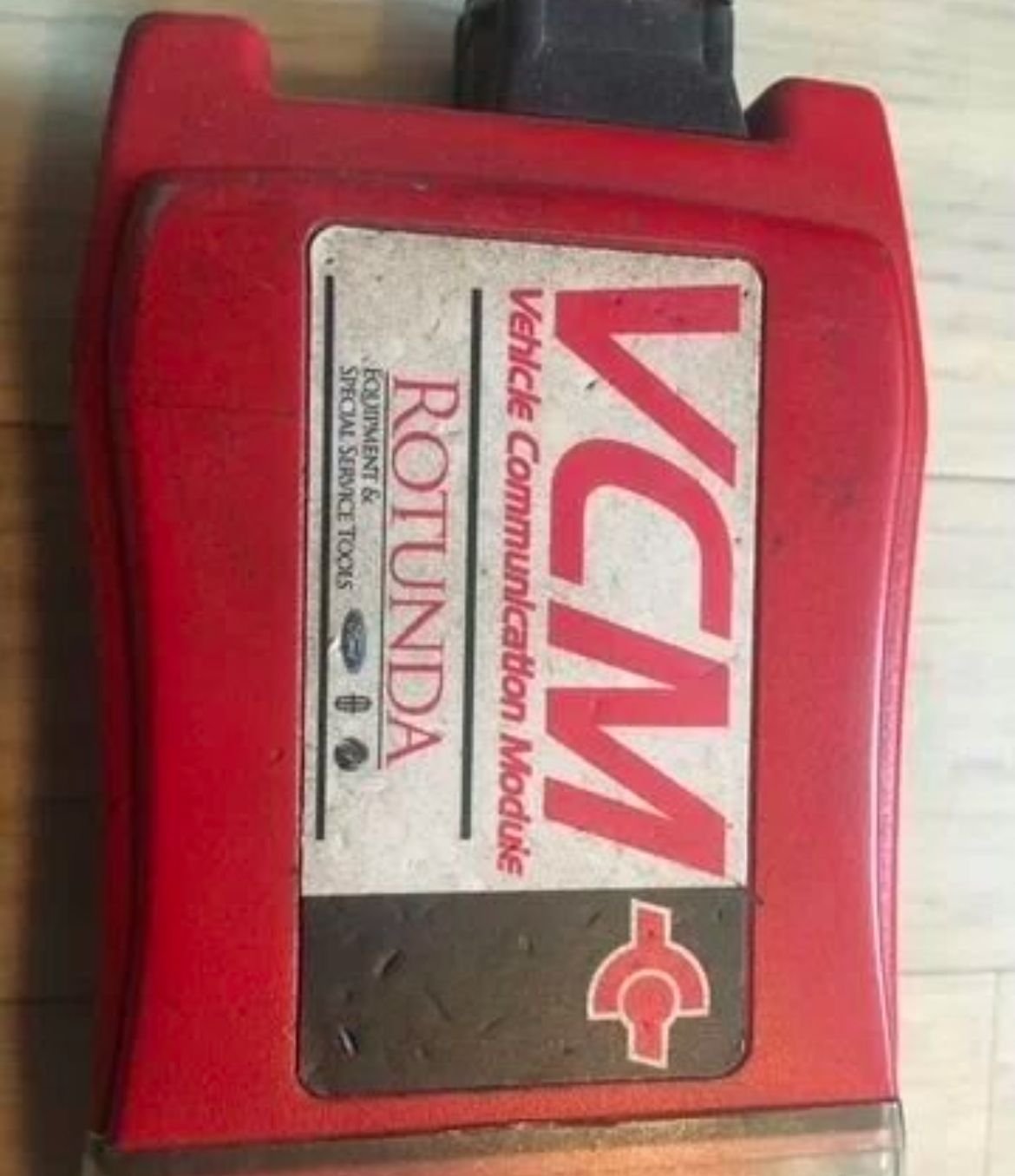

IDS 118.5 requires a Teredyne/Genrad VCM with cables.
A generic J2534 interface will NOT work with IDS 118.5
SDD 125 onward will work with these devises.
Do you have a VCM?

Thanks for the answer. I have a scanner like in the photo, it's a clone, not an original. Mongoose with sdd version 130, 139 does not read vin.
